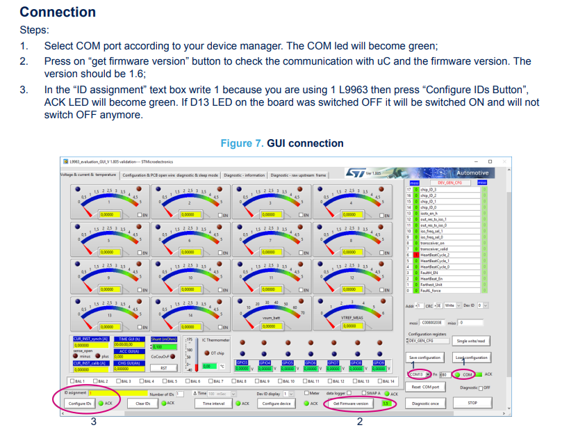

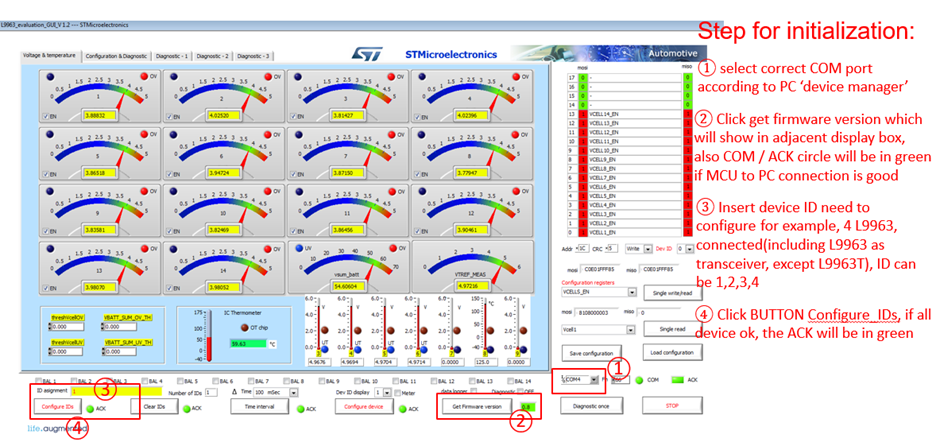

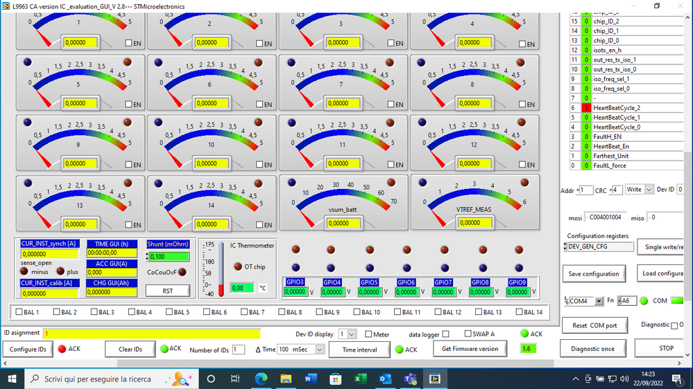

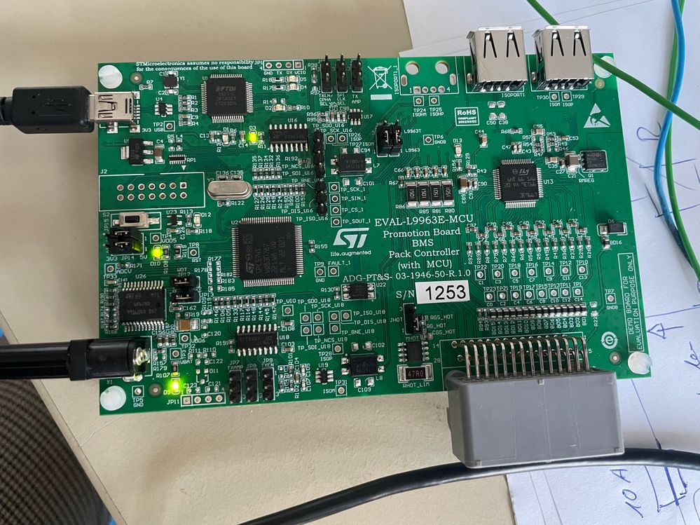

Hi, i have purchased an EVAL-L9963E-MCU and i am trying to test it with the STSW-L9963E GUI. I'am following the application note AN5696 but i am stucked at the third point of the connection section (see sreen).
The main issue is that when i enter 1 in the ID assignment, as i'm using the L9963, the ACK LED wont turn green but red instead. The D13 LED on the board behaves consistently with what is written in the application note i.e. is tuned on when the Configure IDs Button is pressed. Do you know how to solve this in order to test the L9963 functionality? Thanks in advance.0693W00000Sw0G2QAJ.png0693W00000Sw0FdQAJ.png

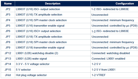

    There is an issue when using only 5V USB to power the board apparently.
    Use 12V PSU to power the board.
    Jumper settings for 12V PSU

    Thanks for the reply. That was the problem, now it is working.

    I'm powering the board with 12V and have the jumper settings like you told us but it’s still not working. 0693W00000Y7qANQAZ.jpg

    the 12V brick powers the MCU , but the L9963E is separately powered via the P2 multi pin connector. Please refer to attached application note.
    If you don't have battery , minimum connection is 12V power supply to VBAT_CELL pin and GND_B.
    Procedure -
    1. Supply power to L9963E via P2. LED D13 will be switched on.
    2. If the addressing procedure from the MCU is not executed within 30 s, L9963E will go in standby mode - LED D13 will be switched off, and you will need to restart from 1.
    3. Supply 12V power to Eval board MCU via X1.
    4. Connect USB cable to P1.
    5. Open the GUI. Follow below steps - make sure "Configure ID " is pressed only once !

    Hallo,
    now it´s working. Thank you very much for your help.
