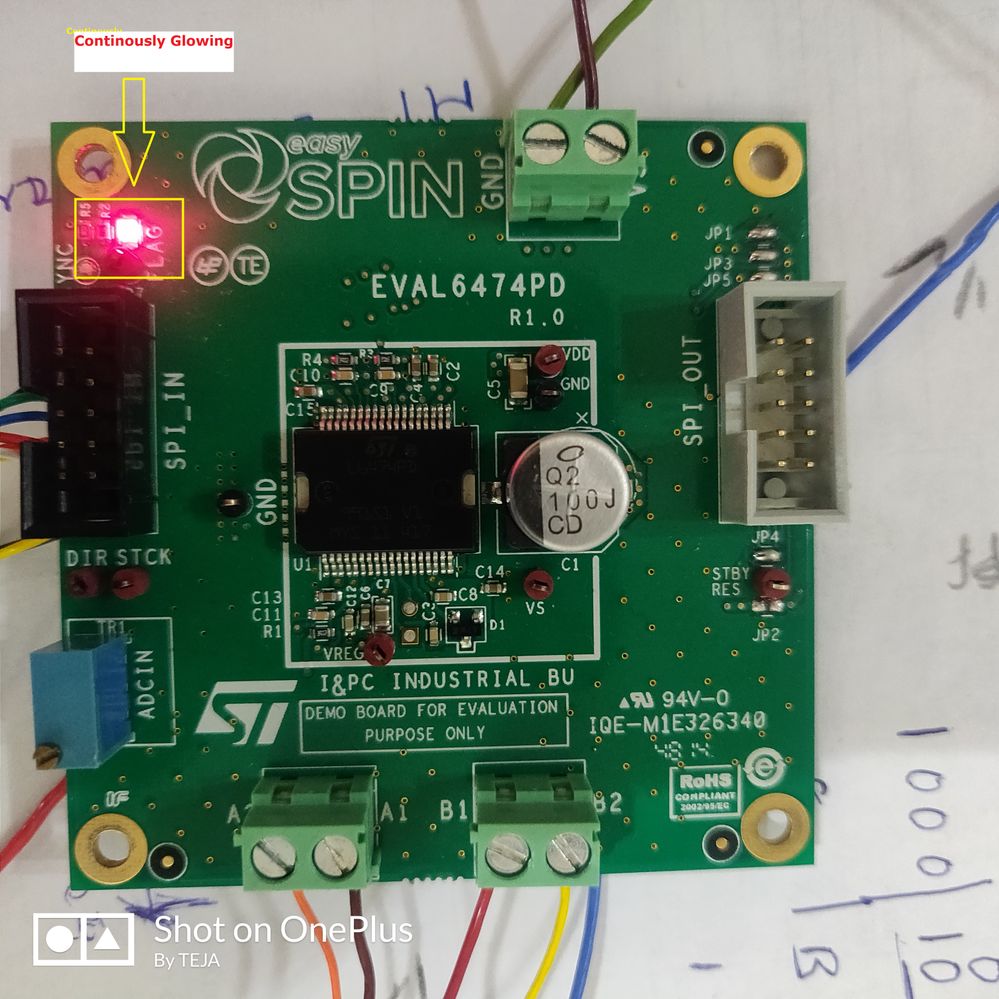

Hello, I am using L6474 drive to drive the stepper motor and I am having issues as mentioned below.
MYadw.1
In status register the UVLO,TH_WRN,TH_SD and OCD flags are active low as mentioned in data sheet.
In this the UVLO flag is set by undervoltage lockout or reset events (includes power on). So, when I read the status register the UVLO flag is always setting i.e. 0 is this the error occurred due to undervoltage only and whether it resets when I read status register ?
The NOTPERF_CMD and WRONG_CMD are always high. Why it is not resetting when I read the status register ?

The GetStatus command returns the current Status register value and then resets the STATUS register warning flags.
To read the STATUS register reset you must send a second GetStatus command.

Hi @Cristiana SCARAMEL​
In both the cases it is showing the same value.
And I am getting the UVLO error continuously after giving proper voltage also.

During power-up the device is under reset until the following conditions are satisfied:
  • VS is greater than VSthOn (8.2 typ.)
  • VREG is greater than VREGth (2.8 V typ.)
  • Internal oscillator is operative
Are you sure all three conditions are met?
We attached a PIC of drive error which is getting please find it below.
As You mentioned we checked the above three points are coming correctly.
  1. Oscillator output is getting 2 MHz clock.
  2. VREG is Getting 3 Vdc.
  3. VS is 24V.
We are able to rotate the motor with drive but we are getting that error continuously.
We have enabled only four errors in Alarm_EN register.
  1. Over current.
  2. Thermal Shutdown.
  3. Thermal Warning.
  4. Under voltage.

Hi @Community member​,
please share the SDI and SDO waveforms when you send the GetStatus command and the returned status register value.
Also, did you configure the L6474 parameters of the control system properly?
You can refer to the Application Notes AN4158 for the driver parameters setup.
