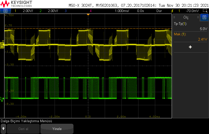

We have designed an ESC according to STEVAL-ESC002V1 and used ST's 6Step_Library. In our application, There are commutation, noise and maximum speed problem.
  • MCU and gate driver is STSPIN32F0A
  • MOSFET is STL220N6F7
  • Switching frequency is 32kHz
  • Zero crossing timer frequency is 250kHz
  • Motor parameters:
    • 14 pole pairs
    • Max. 5300 rpm at no load (We can rotate only at 5200 rpm)
  • using OPEN_LOOP, COMPLEMENTARY_DRIVE, ST_PWM_INTERFACE, SENSE_COMPARATORS, FAST_DEMAG macros
What can be the problem or is there another library that we can use for our application?

VinsmokeSanji
Hi Cristiana,

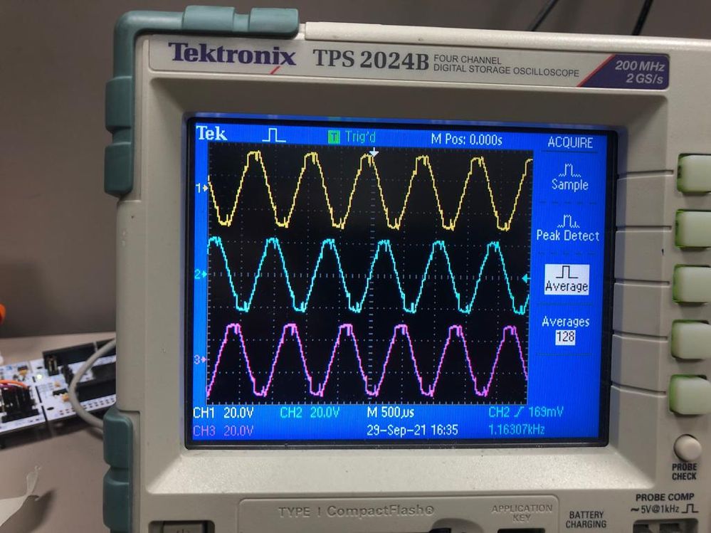

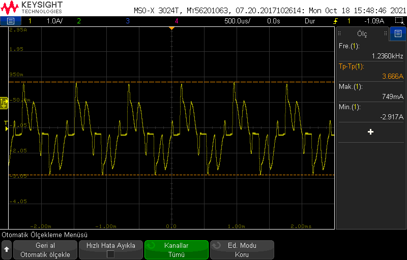

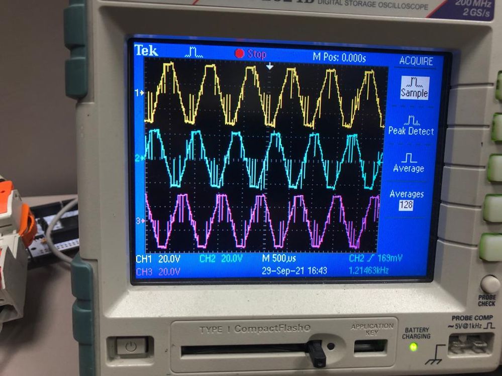

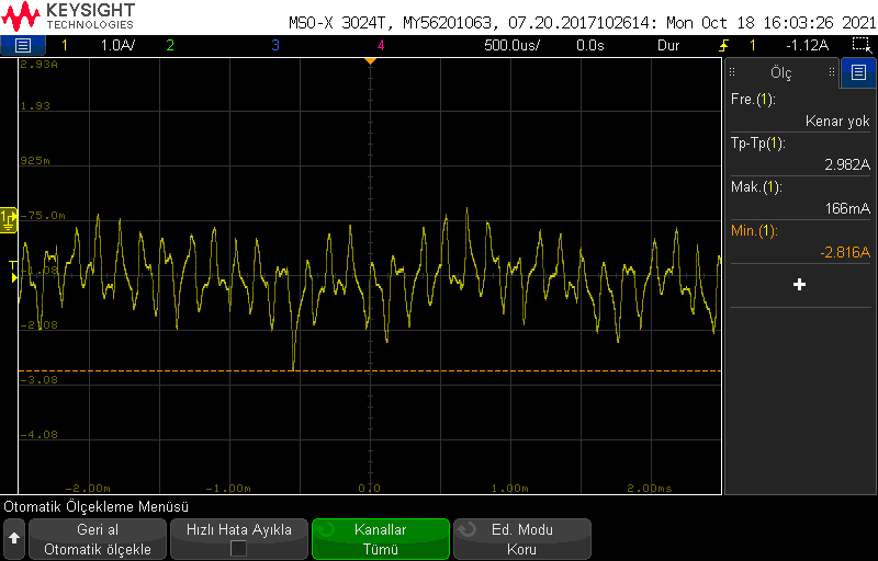

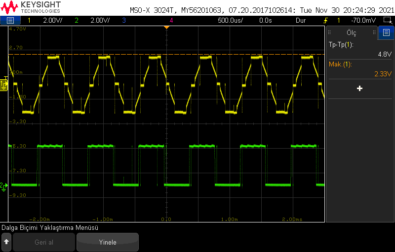

Based on our observations, supply voltage does not change. At the same environmental aspects, Air 40A ESC's noise is 86 dB and our ESC's noise is 92 dB. You can find motor phase and current signals files attached.0693W00000GW4mHQAT.jpg0693W00000GW4m7QAD.jpg0693W00000GW4lTQAT.png0693W00000GW4lOQAT.png
Hi @Yasin Türk​,
please provide the above requested waveforms: one motor phase and respective Op Amp signals in the same screenshoot.
If you feel a post has answered your question, please click "Accept as Solution"

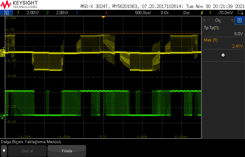

Hi Cristiana,
I am sorry about the late response. I added one motor phase and respective op-amp signals. Opbemf1 and Opbemf2 are signals at low speed. Opbemf3 and Opbemf4 are signals at maximum speed. Opbemf5 is also signal at maximum speed but voltage resolution is at 5V.

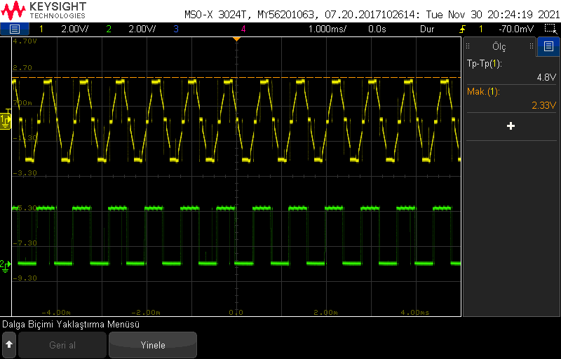

Hi Cristiana,
I noticed that I didn't add Opbemf1, Opbemf2, Opbemf3 and Opbemf4. You can find them below.
Thanks in advance.
0693W00000GZUQSQA5.png0693W00000GZUPFQA5.png0693W00000GZUOqQAP.png0693W00000GZUOlQAP.png
