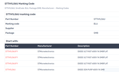

I have a board with an ST component in SMB housing (a diode?) marked BL6, next line GP 733. What part number could this be?
AScha.3
maybe:
2 REPLIES 2
AScha.3
maybe:
The  "GP 733" is a production plant and date code.
