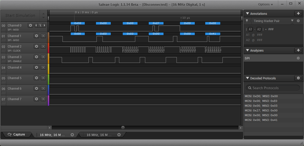

I need a right SPI configuration and Send_Receive_byte() funtion for using with STM32F4, STM32CubeMX 4.7.0 and HAL drivers... Does anyone have it?
I have a project running fine with STM32F4xx StdPeriph_Driver V1.2.0 to connect my STM32F4 and my L6482H chips.
Now, I am trying to migrate my code, for using STM32 CubeMX v4.7.0 and HAL drivers. See below:

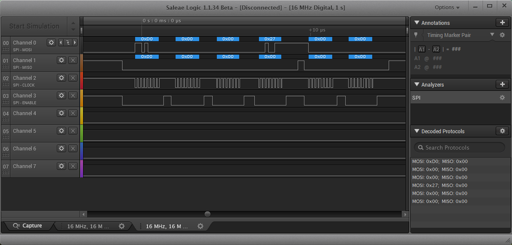

But it doesnt work.
As you can see in pictures, the waveforms
seem
correct
, but it does not work...
With STM32F4xx StdPeriph_Driver V1.2.0
(it runs fine)
With STM32CubeMX and HAL drivers
(It does not run, and MISO always returns 0x00)

Are you sure the issue is in the firmware and not in the hardware?
According to the waveforms the MOSI is ok but in some way the MISO (SDO of the L6482) is stuck low during the transmission.
I see two possibilities:
- The L6482 is not operative
- Something (STM32?) is keeping the signal low. But in this case you'll probably damage the SDO pin of the L6482
Regards
