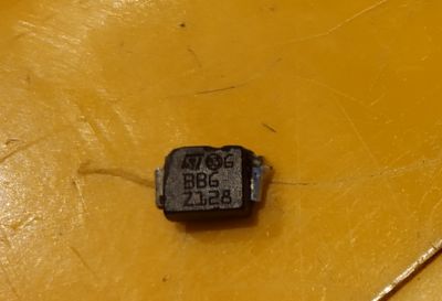

Component identification
Raj3
 not any data available in Google pls identify the components.
Peter BENSCH
BBG stands for the SMBJ15CA.
Hope that helps?
Regards
/Peter
