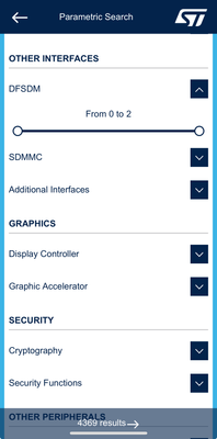

Hello @EasyNet
What i suggest you is to use the STM32CubeFinder (the mobile app is always updated with the latest MCUs). You can use the filters to select the interfaces you are looking for. It will give you all compatible MCUs. Also, to know if you can use peripherals on the same time (no conflicts), you can create a project using the MCU and enable the interfaces. It will show you if this is possible or not.

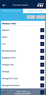

Hi @Issamos ,
Is similar with STM web model. Doesn't shows how many FMC controllers and how may LTDC controllers they have.
Thanks.
You can use the Parametric search to select how many FMC, LTDC or any other peripheral you are looking for:
Best Regards.

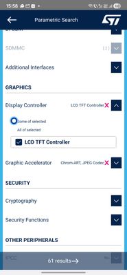

@EasyNet wrote:
Hi @mƎALLEm ,
Regarding the dual LTDC to connect 2 displays on same MCU, there is any?
I don't think there is an MCU that has two LTDC instances.
Indeed, but there is only check box there:
So you can't search for multiple peripherals like I2C, SPI etc. That's why I was asking.
The Check box means there is only 1 instance per MCU for this interface. If more interfaces available, you will find a scroll bar to select the number of instance:
Best Regards.
