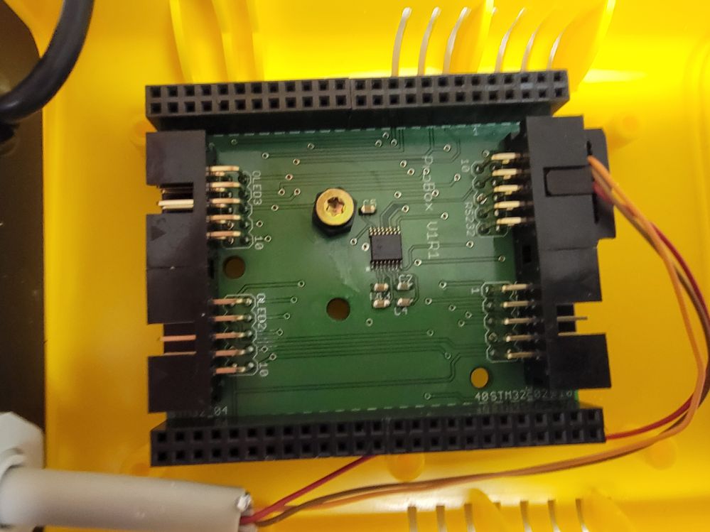

I am trying to troubleshoot and reverse engineer a project no longer in production and for which the developer is no longer reachable.  The project is based on the ST MB997C and uses an attached daughter board that serves as an R232 communications interface to external I/O (whatever other functions it may perform are unclear).  Are there PCB suppliers that manufacture MB997C compatible PCBs to provided specifications?  The subject PCB in this project is silkscreened with the project name "ProBox V1R1", so it is not a generic OTS part.  Also, are there resources out there that can reverse engineer the functions of this PCB?  Any guidance would be greatly appreciated.

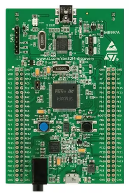

What do you mean by "ST MB997C"? STM32F4DISCOVERY board?
I don't think "ProBox V1R1" board is a ST product we don't know how to help here..
Andrew Neil

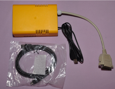

Googling* "ProBox V1R1" finds this:
https://www.facebook.com/groups/1454328184881203/posts/3897897383857592/
in a group about "Mackie d8b".
Maybe that would be a better place to ask about this?
As to general resources for reverse-engineering PCBs, just visual tracing of the tracks and/or a continuity checker.

Adding "mackie d8b" to the search finds this:
http://www.probox-controller.com/downloads/documentation/user_manual_V2-01-17-1.pdf
Which contains this picture:
Is this the product you're talking about?
If so, there's a contact email address in that document.
Other resources here: http://www.probox-controller.com/

Another FB thread of people reverse-engineering (what appears to be) this thing:
https://www.facebook.com/share/p/1asamYwLJH/
This post concludes that the board just provides an RS232 transceiver:
https://www.facebook.com/groups/1454328184881203/posts/3867040220276642/?comment_id=3867247823589215&reply_comment_id=3867291836918147
The MB997C nomenclature can be seen on the image of the PCB in your post.

@bitSync wrote:
 you must design your own baseboard (mate board) that connects to the header pins of the MB997C ...
Generally, the Discovery Board (eg, MB997C) would be considered the base board - so what you design would be an accessory to fit onto the Discovery base.
