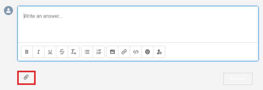

you can add your project in the comment with .zip extension by clicking on this icon (as shown the below figure.
_legacyfs_online_stmicro_images_0693W00000bjDsnQAE.png Kaouthar
