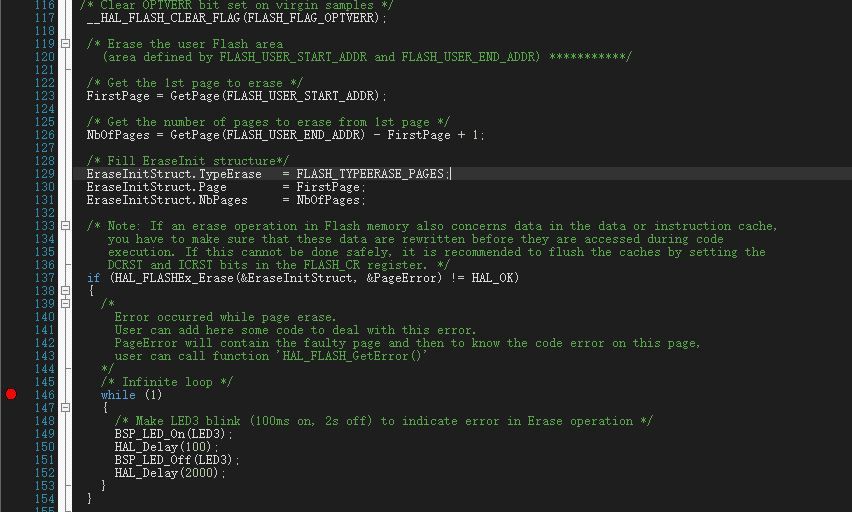

i'm using stm32c011f4u6 mcu's DK(stm32c0116dk), and i generate the file as mdk-arm and it's running with keil5.
i tried erase to test the flash memory, but it doesn't work. i even used the SDK example file, and i get the same error.

An error occurs in the function including breakpoint in the picture above. if i run the program, i'll be stuck in that infinite loop.
Why is this problem happening?

Hello @KenLee and welcome to the community :),
Do you encounter the same issue when using STM32CubeIDE toolchain?
I think that this issue of  Flash Erase in Keil is due to breakpoints.
Could you please try to disable this behavior by following the instructions provided  here.
Also, I recommend you to take a look at this discussion may help you.
Please let me know if the issue is solved.
Thank you.
Kaouthar
Thank you for Reply.
As you said, it is works well in CubeIDE. But, in Keil5, Unlike the contents of the link you sent me, an error occurs even though there is no breakpoint when debuging.
Also, errors do not appear on other PCs that use the same code and compiler. then, it is hardware problem? i'm really confused.

Thank you for your response.
As your advice, My MDK-ARM toolchain version was not V5.36.
I checked the version when I installed the SDK, but I guess i was mistaken for something.
Anyway, After changing the version to V5.36 and trying again, the program works very well now. Thank you!
