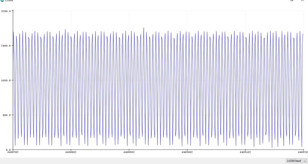

0690X000008BIvyQAG.jpgI want to configure ADC on STM32(Nucleo-F401RE) using Arduino IDE and transmit the values through SPI to Basys 3 FPGA(End Goal). The ADC works for input signal frequency only below 100Hz. How do I increase the throughput rate? My project requires conversion of input analog signal between 500KHz to 900Khz.
Attached is the plot for input freq 1KHz,1.2V,Sine wave from Arduino Serial Plotter

In the past,I have used Keil and STMCubeMX. It did not sample the input signal below 100Hz which was achievable using Arduino IDE. I have tried increasing the sampling cycles, the issue persists. Configured ADC without DMA with HAL_ADC_Start function and transferred the values to PC through UART,still unable to retrieve the original signal. I'm unable to isolate where the problem lies. What am I missing?

waclawek.jan
May 6, 2019
I'd say
> Serial.println(val); // debug value
takes cca 10ms.

Ozone
Principal
May 6, 2019
> Serial.begin(115200); // setup serial
Some rough bandwidth estimates are helpful before starting to implement.
115200 bps gives you about 10 kbytes per second - without overhead.
archana95in
May 6, 2019
Okay, thank you! I increased the baud rate to 2000000 and works till 400Hz. But I'm still quite far away from the range I would require.  STM32(Nucleo-F401RE) ADC of 2.4MSPS sampling rate. Can I expect better results if I send the values to FPGA, store them in a memory and transmit then using UART ?
Ozone
Principal
May 6, 2019
Best option would be to drop the real-time UART transmission. Isn't it for debug anyways ?
With two bytes per ADC value and >2 Msps get you roughly 5 MBytes/s, or 50Mbps of required bandwidth.
Perhaps USB or ethernet, but not UART.
