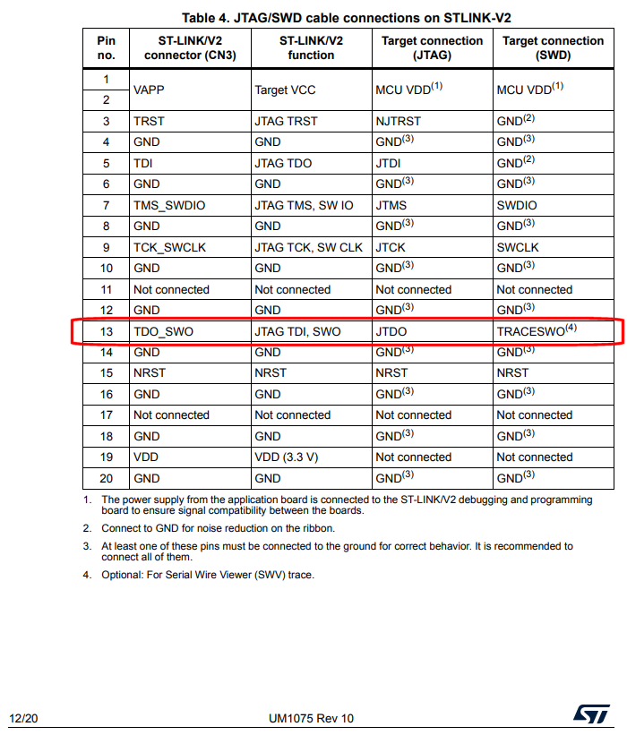

All clock setup and tracing enable checkbox checked and port0 selected but still no SWO printf debug messages in CubeIDE debugger.  Further research led to the SWO pin function (PB3) that deliveres the trace data from the board to the debugger. However Blackpill's SWD header only has four pins GND,Vcc,CLK,DIO, enough for firmware flashing, manual memory inspection but I fear not for SWO tracing .
Is my "analysis" correct, that the stock SWD header is per design not capable of SWO tracing?
ST-Link V2 only offers one additional pin (besides NRST) named SWIM on its 10-pin connector.
I assume that is not where PB3 ought be connected to, correct?

For https://stm32-base.org/boards/STM32F411CEU6-WeAct-Black-Pill-V2.0.html you can access SWO (JTDO)  as PB3 Header 2 pin 11. Or consider RTT.

Yes but, as @Uwe Bonnes said, there's nothing to stop you accessing PB3 (and, thus, SWO) via other headers on the board.
That's a fake (aka "clone") ST-Link, then:
https://community.st.com/t5/stm32-mcus/how-to-recognize-a-genuine-st-link-v2-versus-a-cloned-one/tac-p/703663/highlight/true#M965
A genuine ST-Link V2 has a 20-pin connector, and does include SWO:
https://www.st.com/en/development-tools/st-link-v2.html
https://www.st.com/resource/en/user_manual/um1075-stlinkv2-incircuit-debuggerprogrammer-for-stm8-and-stm32-stmicroelectronics.pdf#page=12

so finally the dust settles:
1. all 10-pin ST-Link V2 gadgets in sleek aluminum casing are non-genuine,
lacking a lot of ST-Link's options, most prominently the TDO_SWO pin necessary for debug printf
2. to by able to debug a Blackpill using SWO one needs the huge soapbox ST-Link
and a wire from PB3 to TDO_SWO pin on the 20-pin header
3. old school alternatives like using USART or - as I did - USB_CDC as debug output device are available
4. still the parameters from the ST debug docs apply:
Clocks must match, TRACEEN must only be activated AFTER the configured clock (for example HSE) has stabilized.
(I presume that is what the click-on-.the-red-dot-in-debug-console is doing)
=> soapbox ST-Link is already ordered.
Other, smaller, ST-link versions are available; eg, https://www.st.com/en/development-tools/stlink-v3mini.html
Other purveyors of SWO-capable debug probes are available.
Also, the signalling on SWO can be UART - so you could just use a UART to receive it:
https://community.st.com/t5/stm32-mcus-boards-and-hardware/uart-signal-on-swo-pin-from-st-link-v2-3/m-p/742817/highlight/true#M22588

Yeehaw! with a soap box ST-Link (NOT the tiny aluminum cased ST_Link ripoffs)
one can connect BP3 (JTDO) to the TDO pin (pin13) on the St-Link and
voilá beautiful debug output, directly in CubeIDE!
Time to hone my debugger skills (watch data content etc)
