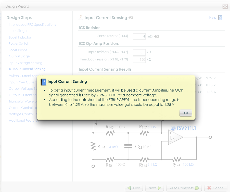

I found a problem in eDesignSuite when i try to use STNRGPF01 (PFC boost interleaved IC).
At input current sensing the ICS Target Voltage is 3.00V and in the datasheet the ICS Target Vltage looks like it is 1.25V (also in the Help section of eDesignSuite). Which one is correct?
Also, is there any other datasheet (maybe we need to sign an NDA for it or smth like that) because the one on the site is very poor.

    Best answer by Carmelo VICCICA
    Hi Mihai,
    In short 1.25V are a limitation on inside comparator present in this family products, as specified in pag 32 (table 14) of datasheet (https://www.st.com/resource/en/datasheet/stnrgpf01.pdf)
    So every time user have necessity to compare a signal using internal comparator, the pin should have following range 0-1,25Volts.
    This is the golden rule, in solution proposed, applied on
    - Input Voltage Sensing Circuit,
    - Output Voltage Sensing Circuit,
    - Output Current Sensing Circuit,
    where output go directly to a STNRGPF01's pin for comparision.
    On the contrary on  Input Current Sensing Circuit, the output of this module is a input for PI regulator so only in this case we can use a different target voltage according to the IC used in the Current Control Loop (https://www.st.com/resource/en/datasheet/lmv321.pdf).
    The two resistors R58 and R62, between PI's output and OUT_PIN, give a scale factor of 0.635 that ensure the correct voltage on OUT_PIN pin.

    Hi Mihai,
    Thank you for your interest in ST Portofolio.
    About your question.
    The information on the "Help" is older and refers to the first version of the proposed solution, so please refer to the information in the ICS wizard.
    Thank you for reporting, we will update this information on the next version, which should be released by 2018.

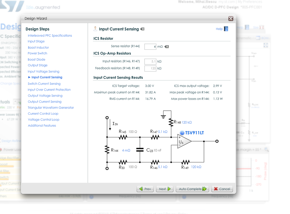

    Hello @Carmelo VICCICA​ .
    You're right, i don't know how i did missed that. Thank you very much!
    But i got a few more questions, if you are kind enough to help me:
    1. At the input crrent sensing circuit, RMS current is ok, but the peak current is huge, i got a 3kW design, for calculating the RMS current on shunt resistor, formula is Pout_total/(Eff*Vline_min*PF), Pout total is the maximum power (in my case 3kW), Eff - efficiency, in my case 95% and PF is the power factor, in my case 0.99. This result in about 16.8A. This is what designsuite shows for maximum current also, but the problem is that it says that the maximum current should be 31.82A, and i don't know how it could be. Maybe if you didn't have any soft start-up and your current would only be limited by the capacitors resistance. Can you explain that? I will attach a photo also.
    2. Another question is about maximum output voltage of the PFC. You can calculate with a ripple of 5%, given that your output will be, let's say at 380V, and you can get a maximum of ~399V, but the maximum output voltage is stated as 426V. In the description of that maximum output voltage it says something like this is the mximum voltage that the PFC can reach in any conditions, but i am not sure what are those conditions..
    3. In the datasheet the pins R[1]...R[4] are reserved, but in the steval-ipfc01v1, the pins are tied with the switch current readings, what is the "correct" way?

    Carmelo VICCICA
    October 29, 2018
    Hi Mihai,
    Thanks for your questions, I will try to answer them.
    About first question on ICS circuit:
    The maximum peak current on R144 is calculate by following formulas
    Ipeak = Irms * Math.sqrt(2) ( 1 + ripple/n) * margin
    where :
    • ripple is Acutal current ripple percentage (value taken from Boost Inductor Page) ~0,69
    • n is Number of Channel = 3
    • margin : marging factor to protect sistem = 1,05
    with previous formula Ipeak is always 1,83 x Irms

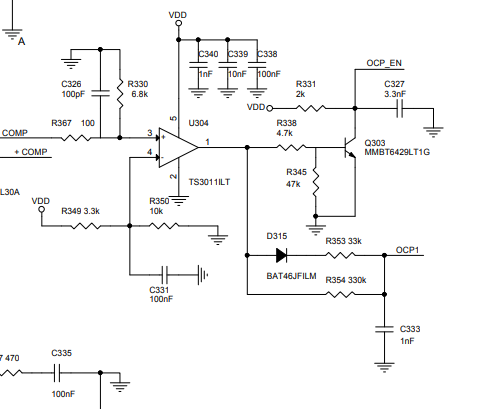

    Iliescu Mihai
    October 31, 2018
    Hello @Carmelo VICCICA​,
    Thanks a lot for your answer, for the second and third questions i understood. For the first one i understood what is the formula but it doesn't make much sense. Anyway, i will use it as it is, and will come back with much more details after the first prototype testing.
    I got another question (i will use your link - https://www.st.com/resource/en/data_brief/steval-ipfc01v1.pdf for the schematic).
    In the 4th page, where is the comparator circuit (U304) your negative input is ~ VDD(5V)*10k/(10k+3k3) = 3.75V. The input of the comparator is maximum 1.25V(-0.3 or -0.4 from the diode) so how it can ever switch?
    On the design suite, the resistor divider it is correct.
    So, you have RocpL/(RocpL+RocpH) x VDD => 5*1.8/11.8 = 0.70V - that's correct.
    So, i guess your board kit has a mistake?

    Carmelo VICCICA
    November 6, 2018
    Hi Mihai,
    We apologize for the delay in the reply, but we are engaged in other projects.
    The documentation present in website refers to STEVAL-IPFC01V1 where all OP Amplifier are supplied with 5V, so the input of U304 will be have a range from [0 - 4,7V].
    eDesignSuite refers to a previous version of board where all OP Amplifier are supplied with 3V (EVAL-IPFC01V1).
    In the future eDesignSuite will be updated to match with actual documentation of STEVAL-IPFC01V1.
    Both designs are correct according to supply voltage selected for IC.

    Iliescu Mihai
    November 15, 2018
     Hello again @Carmelo VICCICA​ ,
    I got another question about your STEVAL board.
    Here you can see that the output of U304 - an output of 5V is going directly into the IC (OCP[1] - which is a 1.25V maximum allowed) how that the chip still works?

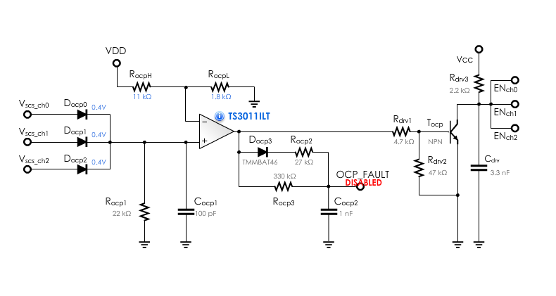

    Carmelo VICCICA
    November 16, 2018
    Hi Mr. Iliescu
    about your questions, below you can find some clarification how system works.
    Q: "Here you can see that the output of U304 - an output of 5V is going directly into the IC (OCP[1] - which is a 1.25V maximum allowed) how that the chip still works?"
    R: In case of consecutive OCP events, C333 is charged until the FAULT voltage level (1.23 V) is reached on OCP[1] PIN 28 of the STNRGPF01. At this point the system is stopped so the voltage cannot increase above 1.23 V, but in any case the pin is 5V tolerant so no problem.
