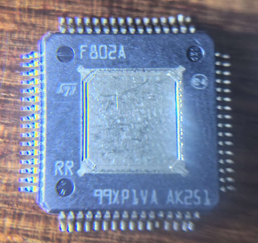

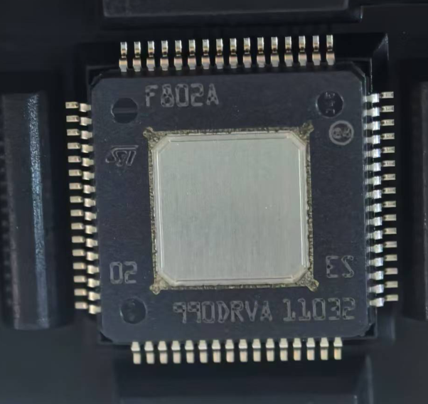

Hi Engineer,
Happy new year.I have a issue for the belows two pictures.Could you pls let me know the meaning of bottom line marking?
"99XPLVA  AK251"   and  "990DRVA  11032"
Since I dealing with a new product design.It's urgent for us.Much appreciated for you support!

Peter BENSCH
January 3, 2025
Welcome @Charleslyu, to the community!
Only the last three digits of the line are relevant and show the date code WWY, where WW is the calender week and Y is the last digit of the year of manufacture. The other nine characters in front of it are internal markings.
Hope that helps?

January 3, 2025
Hi Peter,
Thank you very much sir.I appreciate your quick reply.So this is the PN what I need,just the different datecode right?
FDA802A-VY
Charles,
Thanks,
Peter BENSCH
January 3, 2025
FDA802A-VY is the PN, with a additional Y for tray or a T for T&R appended.
