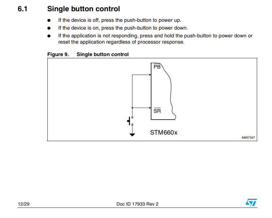

I want to use the STM6600 controller to manage the power ON/OFF of my microcontroller system. In the specific I want:
- Turn ON the system simply pushing a button.
- Turn OFF the system simply pushing the same button.
- Force the power OFF pushing and holding the same button.
I read at pg. 5 on the STM6600

In this case it says that, to disable the EN signal, I have NECESSARILY to push two button: the &sharpPB and the &sharpSR simultaneously.
Now I'm a bit confused. If I want use only one push button to have the behaviour described above, I have to connect to ground permanently the &sharpSR input of the STM6600 controller?

0690X000006CHLQQA4.pngHi Andrea. I too am confused by the ST data sheet. I think it is VERY misleading regarding the long switch push description. I filed a case with ST tech support regarding the information but have not heard back.
I did however come across app note AN3271. It shows how to use one switch to perform the on/off functions as well as hung processor power down from a long press. I've white wired my STM6600CS25DM6F and it does work very well. Hope this helps.
