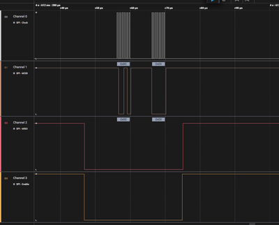

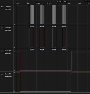

Hi , i am trying to read the sensor data of AIS2120x only for sensor ID type , i can see from the bus the data is transferred correctly, but i don't receive any data back from sensor rather its only 0.
i have attached the code snippet for this test, any leads will be helpful. @JHo.1

Its worked now(change is downscaled the spi clock to 500K), thanks all for the reply, but still i am not sure why the clock frequency must be less than 1Mhz even datasheet says 5Mhz.

SPI bus log attached
Is that before or after the level shifter?
Show what's actually happening at the sensor's pins.
Have you also looked at the signals on an oscilloscope? Are they clean?

SPI trace attached already from the sensor pins, i have not tried with 3,3MCU voltage since 5 V is operating for this mcu
Above trace is recorded from sensor pins

According to its data sheet, table 49, the SPI of the AIS2120 can work up to max 5MHz.
But it expects 32-bit frames, which is also mentioned in the data sheet, section 5. Your screenshot of a frame only shows 16-bits?
