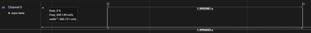

In the meantime, I was able to measure the LPUART1 communication, while Simulink tries to connect to the board. At the same time I analyzed the USB commands using a serial port analyzer. The files are attached. The RX signal of LPUART1, I measured at SB23 and TX at SB17.
On the TX, I don't see anything. On the RX, I receive two data patterns followed by each other with a delay of 2s:

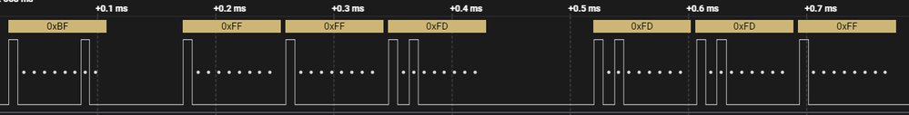

_legacyfs_online_stmicro_images_0693W00000bi1QBQAY.png If we look closer to one data pattern using the following serial interpretation settings

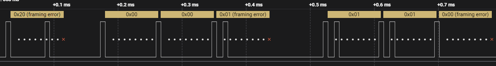

_legacyfs_online_stmicro_images_0693W00000bi1GbQAI.pngI get the following framing errors:

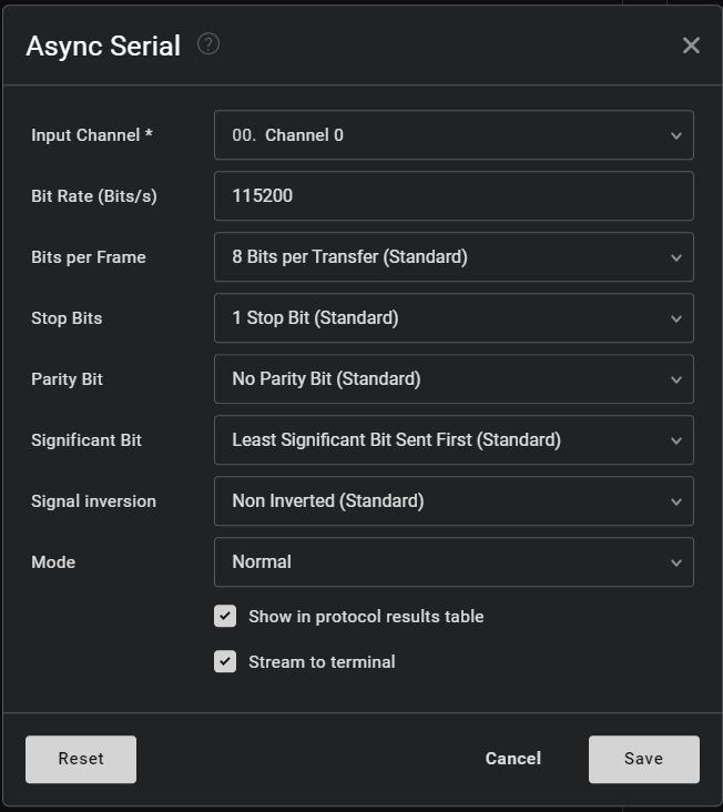

_legacyfs_online_stmicro_images_0693W00000bi1QpQAI.pngAs I have read, LPUART has low active signals, so if I change the configuration to "inverted" as follows,
_legacyfs_online_stmicro_images_0693W00000bi1R9QAI.pngthe framing errors disappear and 7 data words are being interpreted by the logic analyzer:

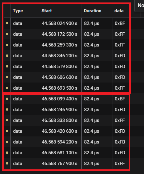

_legacyfs_online_stmicro_images_0693W00000bi1RYQAY.pngE.g. the first data word is 1111 1101. As it seems, the LSB is transmitted first, this translates to BF. Now, these are the two data sequences interpreted in the way described above:

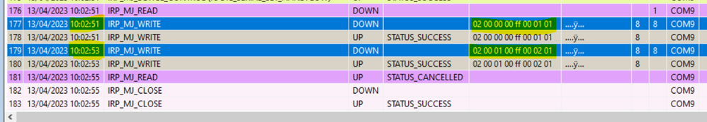

_legacyfs_online_stmicro_images_0693W00000bi1SvQAI.pngWhen I look at the USB serial port analyzer, I see following write commands:
_legacyfs_online_stmicro_images_0693W00000bi1WOQAY.pngThe write commands shown in the picture, are the only write commands in the whole recording. The write commands marked yellow in the picture, are 2s apart from each other, so this makes sense when we look back at the LPUART measurements. However, I'm not able to figure out, how the data sequences seen on the USB, translate to those of the LPUART1.
First, what I don't understand is, that on the LPUART, I see 7 words, on the USB it seems to be 8. And second, the data itself - from my understanding - has no relation between USB and LPUART, or am I missing something?
Since I'm not an expert on serial communications, I would be happy to get some support!
