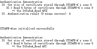

我使用 X-CUBE SAEFA1 在 stm32l151 上的 STSAFE-A110 中运行身份验证例程,串口返回 6 或卡住,寻求帮助

I use X-CUBE SAEFA1 to run the Authentication routine in STSAFE-A110 on stm32l151, the serial port returns 6 or is stuck, ask for help

Hi @ll132435 ,
Thanks for your interest in STSAFE-A product.
The error 6 is STSAFEA_BUFFER_LENGTH_EXCEEDED which append only when you are requesting more bytes than the STSAFE-A internal buffer (507 bytes) but in the authentication() example, there is a read of 4 bytes so this issue shouldn't happened.
Could you please share the version of the X-CUBE-SAFEA1 package ?
Could you also please share the init of the STSAFE-A110 before calling authentication() ?
Thanks,
Best Regards,
Benjamin

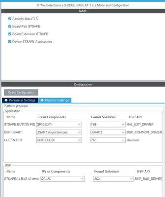

ll132435Author
July 18, 2024
Thanks for your reply.
I use the routine generated by STM32CubeMX, and the package X-CUBE-SAFEA1 is version 1.2.2. I can share my.ioc file with you. I use IIC2 and USART2 for serial port
I don't have  configurations when I create a project
