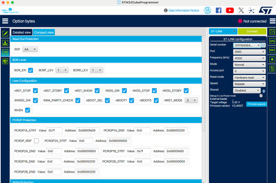

	if (needsLock) {
		/* Locks the option bytes block access */
		HAL_FLASH_OB_Lock();
		HAL_FLASH_Lock();
and it worked. CubeProg now shows that the enable bit is set and the BOR levels are set to 1.

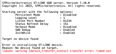

So I change my code to the way that I need it:
#define BORR_LEVEL OB_BOR_LEVEL_RISING_3
#define BORF_LEVEL OB_BOR_LEVEL_FALLING_3
no other changes. Run the program and the net result in CubeIDE is:
CubeProg won't talk to it either.
Another bricked processor.
