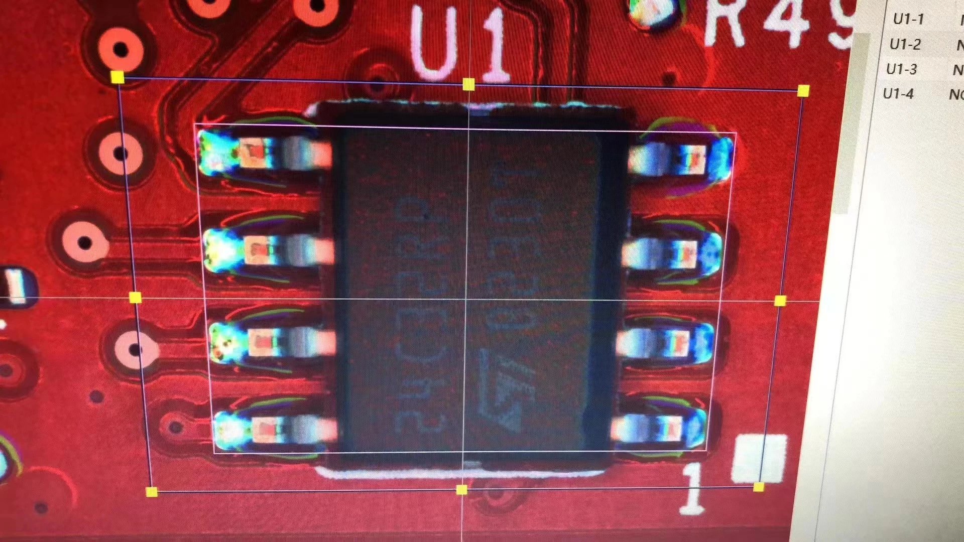

Please help to provide the body marking surface of this material. There is no description in the spec, so it is impossible to confirm whether the material used is correct. Thank you!

It should be 24C32RP.
BR
Pierre

Thank you!  You're right.  The label on the first line is exactly what you said it was.  But can you be a little more specific, because the second line also has labels

2nd line XYWZ depends on several parameters and i'm unable to guess because:
X is 1 digit of manufacturing plant
Y is 1 digit of manufacturing year
W is 2 digit of manufacturing week
Z is 1 digit equal to "T"

Ok, I see. Thank you very much for your answer
