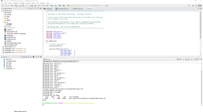

For your information ,
StellarStudio 6.0.0-IRON version is officially pushed (for SR5x & SR6x). (Windows, Macos, Linux) based on eclipse 202309 and the version CDT 202309 with its standalone tools
https://www.st.com/en/development-tools/stellarstudio.html

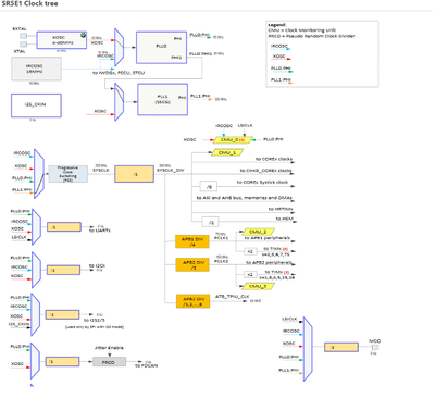

  • StellarStudio Pinmap (SR5E1), Clocktree (SR5E1) (Windows, Linux, MacOs)
    StellarESDK-1.7.0 (SR5X) and TOOLS-1.4.0
  • with Git Bash Eclipse Integration / Update site system.
  • with eclipse project creation wizard based with multiple sdks support (Integration of ESDK 1.7.0,ESDK-1.6.0,ESDK-1.5.0)
  • with new pinmap wizard with board selection mechanism
  • with CDT / embedded cdt / Openocd debug Integration
  • with Migration tool from Old Pinmap to New Pinmap model
  • Compliant with TRACE32 Lauterbach / ISYSTEM / Segger J-Link / Openocd.
What's new in this release ?
-SR5E1:
                        Integration of Stellar ESDK-1.7.0 , Stellar ESDK-1.6.0 , Stellar ESDK-1.5.0
                        Graphical UI configurators for Can, Comp, DAC, Comparator SPI , UART, TIM & HRTIM drivers NEW
                        New Pinmap Wizard (Configurable GUI) (GLSP/Sprotty) NEW
                       Automatic Generation of Openocd Generation NEW
- Application wizard UPDATE WITH NEW SR5 Boards
- Embsysregview update with SVD Update for each device NEW
- User friendliness enhancements
- Bugs fixing
