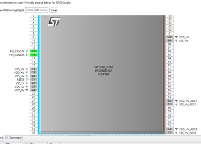

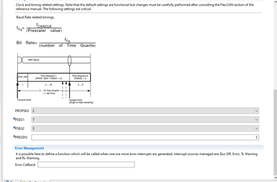

Hello everyone, I am Erdem.
I am trying to use FlexCan with the SPC560B-DIS development board. I ran the example project "SPC560Bxx_RLA CAN Test Application for Discovery," but I didn't want it to operate in LoopBack mode. When I disabled the LoopBack mode, I couldn't read anything from the PeakCan cable. I created a new project from scratch and wanted to send a simple CanBus message, but there was no communication. I am sharing the settings and code from my project in the images. I would be very grateful if you could help. Thank you.
Eakso1_1-1720106774025.pngEakso1_2-1720106797929.pngEakso1_3-1720106838865.pngEakso1_4-1720106894702.png

Please select EXTENDED from filter settings and save all filter settings
2 replies
ErABest answer
Visitor II
July 5, 2024
Eakso.1
Eakso.1Author
July 5, 2024
It is done, thank you
