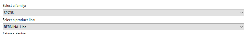

is there any example code about spc58nn in SPC5studio? i cant find example project options.anyone knows where i can find that?

    Hello Mr Zhang,
    when you import a demo, select BERNINA product line
    0693W00000SvgKJQAZ.pngit is the Nick name of SPC58xNxx (inlcuding 58NN)
    Best Regards.

    Hello Mr Zhang,
    Best Regards.
