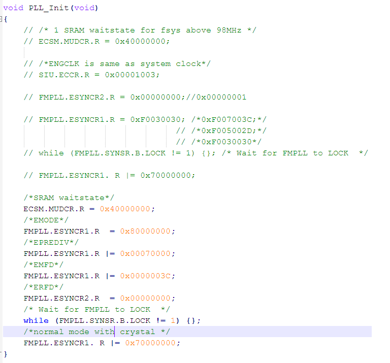

Hello,  I configured in enhanced mode for system clock generation, our input clock is 40Mhz external crystal and need to generate 150Mhz  system clock. Since hardware is not supported to check CLKOUT pin for system clock, we configured SCK clock for calculating system clock.
  • In below code used as provided by ST, but we facing a problem in free running the code ( debug port fail) while debugging the code in TRACE32.
    For below configuration, code is running some exceptional condition. No system clock generation.
    FMPLL.ESYNCR2.R = 0x00000001;
    FMPLL.ESYNCR1.R = 0xF005002D
    while (FMPLL.SYNSR.B.LOCK != 1) {}; /* Wait for FMPLL to LOCK */
    FMPLL.ESYNCR2.R = 0x00000000;
NOTE: For above configuration the parameters values EPREDIV, ERFD and EMFD is not satisfying for 150Mhz system clock generation if we substitute in enhanced mode formula. Im confused!!!!!

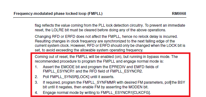

Best answer by Erwan YVIN
Posted on February 21, 2017 at 10:41
Hello Mahesh ,
sorry the RM is not cleared
You should respect some steps
Step 1
Support for 50MHz system clock generation
The oscillator and PLL support generation of a 150 MHz system clock while using the 40 MHz crystal required for FlexRay operation. A possible PLL configuration is shown below: �?
Input clock (crystal frequency): 40 MHz
�? EPREDIV/IDF divider = /8 (1–15 range supported) �? EMFD/NDIV loop divider = 80 (32–96 supported) �? VCO clock out = 300 MHz (256–512 MHz range supported) �? ERFD/ODF output divider = /2 (/2, /4, /8, /16 supported) �? SYSDIV divider = /1 (/1, /2, /4, /8, /16 supported) �? System clock = 50 MHz
Step 2
wait for Lock the PLL
Step 3
�? EPREDIV/IDF divider = /8 (1–15 range supported) �? EMFD/NDIV loop divider = 60 (32–96 supported) �? VCO clock out = 300 MHz (256–512 MHz range supported) �? ERFD/ODF output divider = /2 (/2, /4, /8, /16 supported) �? SYSDIV divider = /1 (/1, /2, /4, /8, /16 supported) �?
System clock = 150 MHz
Step 4
==> It is ok for my side

Mahesh Chamaraja
March 14, 2017
Posted on March 14, 2017 at 09:34
Hello Erwan,
Sorry for the delay
Can I know the values for this macros?
SPC5_FLASH_WS
SPC5_FLASH_BIUCR
