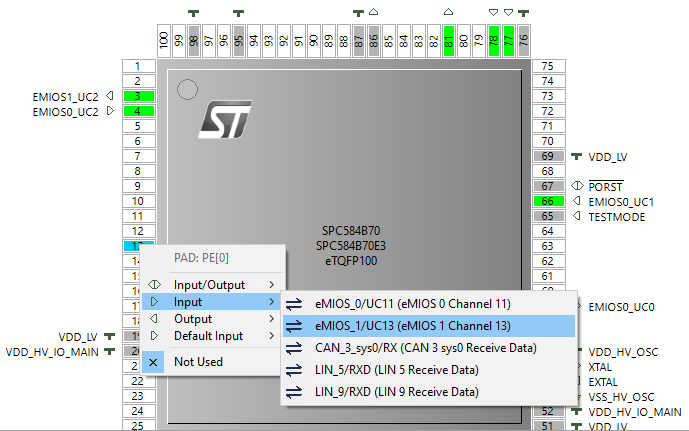

I am using SPC584B70E3 and I want to configure some of the inputs as an ICU. However, the SPC5Studio Limits the ICU for eMIOS0 Channels 0-7 only. I cannot configure PE[0] (eMIOS0 Channel 11 or eMIOS1 Channel 13) as ICU for instance. In the Reference Manual these channels have the ability to be configured as SAIC (Single Action Input Capture) but I do not understand how that is done through SPC5 Studio.
Can you help me with configuring PE[0] as an Input Capture as an example?

    you can open the PinMap editor:0693W00000JMAkdQAH.pngRight click on pad 13 (PE[0]) and selec the source you want (emios0 channel 11 or emios 1 channel 13)
    then save you pinmap, close it
    save your configuration and rebuild all.

    I am sorry if I did not explained my issue more clearly. I know how to set a pin as an eMIOS channel, this is not what I am asking.
    If you go to the eMIOS Settings (under Low Level Drivers Component) you can see that only eMIOS0 Ch0-Ch7 are allowed to be configured as ICU. However, in the Reference Manual I can see that more eMIOS channels have the SAIC functionality. I am asking if there is a way to set a different eMOIS Channel as ICU.

    I had the confirmation that current Low Level Driver do not support more that the 8 first channels of emios0 to be configured in SAIC mode.
    Then you will have to use one of supported channels (ch0 to ch7).

    You are right, it seems the current driver only implements the channels 0 to 7.
    I will ask for Driver team support to be able to answer you as soon as possible.
