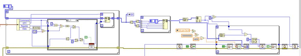

About AIS2120SX chip, can you tell me how to initialize it?
That is, the acceleration from being charged up to being able to read the X and Y axes.
What is the entire SPI operation?
It's very difficult to use this chip.
I tried to initialize the chip, but failed.
Thanks for any help you can provide!

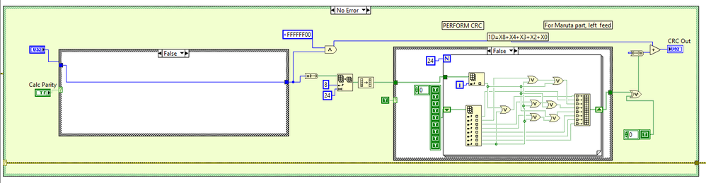

Hi @DDale.1​ , I first would suggest you to read carefully the datasheet,
Then you may be right the chip is not as plug-and-play as almost every other ST sensor, since it is SPI over 32 bit and with polynomial CRC to check the data consistency. I may share you the screen of a labview code for the initialization of a similar chip.
