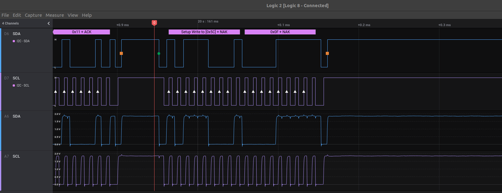

I am integrating multiple sensors from ST, all of which are connected to a central processor via I2C. Occasionally, I find that the LPS22HB is unresponsive at boot up. When the central processor attempts to read the WHO_AM_I register, there is no response. The other sensors work fine.
I can reproduce this behavior somewhat reliably by configuring the main processor to read from the LPS22HB in rapid succession and then power cycling the entire device at random intervals. On some power cycles, everything works fine. On others, the LPS22HB appears unresponsive.
What could prevent the LPS22HB from communicating via I2C?
The following screenshot shows a logic capture (both digital and analog) of the problematic behavior:

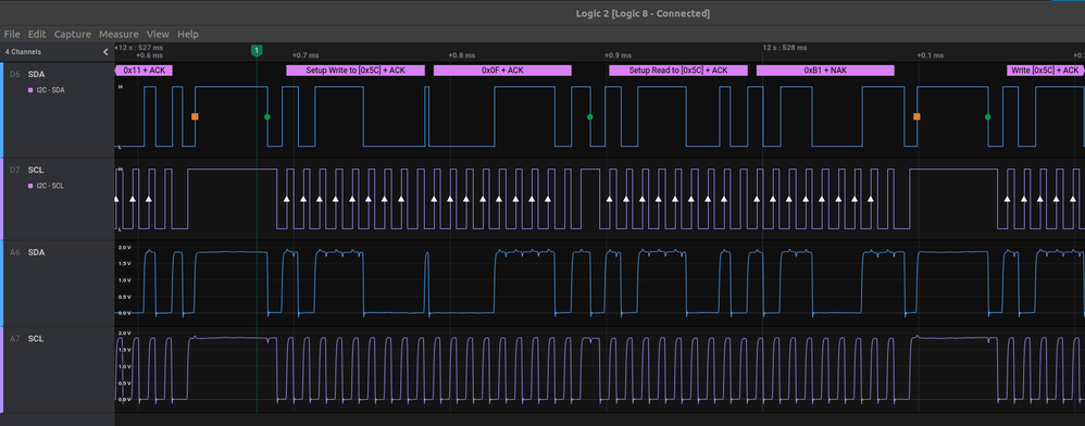

This next screenshot shows an example of the expected behavior, which I observe a majority of the time:

When unresponsive, try to force 9 stop bits on the bus using sw gpio manual toggling. If there is a disruption while reading any device, that device will keep stuck or worse. Bus error recovery is one thing to check. Otherwise, make sure the device didn t switch to spi mode....

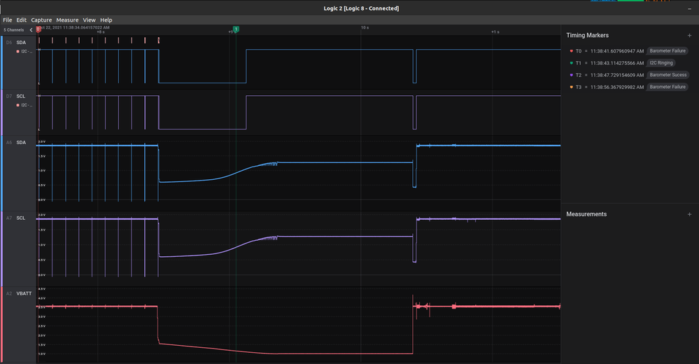

Further investigation has revealed strange behavior at power-on with JTAG connected. It appears that some current is leaking through the main processor via JTAG and putting the I2C pins in an indeterminate state:
0693W00000FDmotQAD.pngWhen this occurs, the LPS22HB becomes unresponsive until the next power cycle, while the rest of our I2C peripherals continue operating with no issues.
