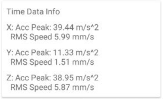

There are two parameters "Speed" and "Acceleration Peak" in time domain (using MotionSP library). What condition (e.g. frequency 10Hz - 1kHz use speed and Above 1kHz use acceleration peak) will be used Speed in time domain and Acc Peak in time domain? Please advise. Thanks!
0693W00000ANx4hQAD.pngSource: Getting started with the STM32Cube function pack for multisensor nodes with signal processing to enable predictive maintenance - User manual

Hi @JTam.1​ ,
you can choose the thresholds for the different values in MotionSP_Threshold.h file included in \Projects\STM32F446RE-Nucleo\Demonstrations\Predictive_Maintenance\Inc.
Hope this helps.
