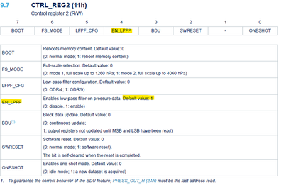

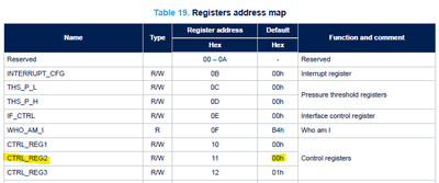

There is a typo in in the datasheet of the ILPS22QS datasheet: DS13431 - Rev 3.
Table 19 on page 32 states that default value of CTRL_REG2 is 00h.
But on page 39, chapter 9.7 CTRL_REG2 bit EN_LPFP has a default value of 1 resulting in 10h
I hope that the page 39 is correct, rather than table 19...
Thanks in advance to confirm.
Romuald
