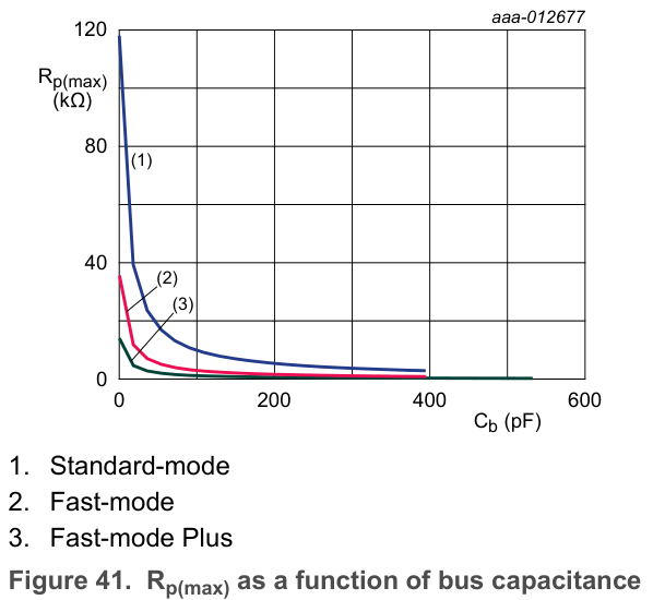

According to the documentation of the NXP, the 10 kOhm covers a very limited capacitance area:

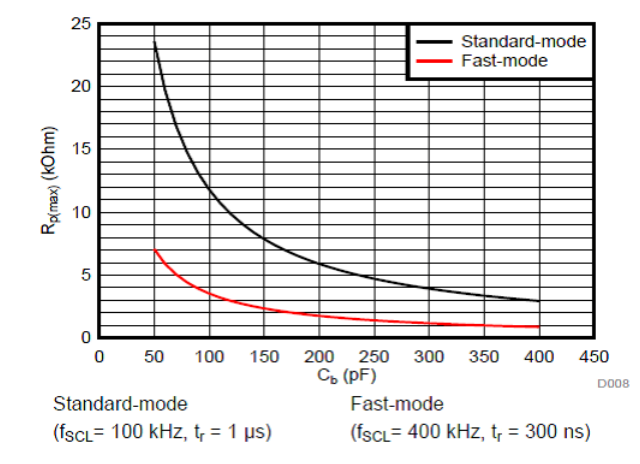

this is the Maximum pull-up resistance value vs. Bus Capacitance value by TI (SLVA689). When it is 10 kOhm, there is no Fast-Mode section (in my opinion, TI seems to reflect the real world a little more...):
as mentioned earlier, the this graph is not an absolutly result. however, the issue between the pull-up resistance and capacitance of the I2C bus is a frequent occurrence. (especially if there are multiple units on a single bus) waveform measurements will be required for accurate solution.
but this is just speculation as well, need more information for a clear diagnosis...

this is not a complete answer, but 10k ohm pull-up resistor can be too strong for Fast-mode. (depending on the capacitance of your I2C bus)
If the waveform measurement is not possible immediately, you will be able to check after lowering the bus speed to 100kHz. you can refer to this document regarding the I2C pull-up resistor: UM10204: I2C-bus specification and user manual. See 7-1 "Pull-up resistor sizing".

I meant, might need a *lower* pull-up resistance value for 400 kHz. (Apologies if the expression was ambiguous)
Like the SO's answer in your reply, the exact need resistance value is very different for each bus design. especially bus capacitance.
