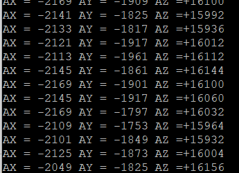

Hello, I'm using the STEVAL-MKI109V3 board in combination with STEVAL-MKI175V1 and trying to read the X, Y and Z values through the serial port using the commands described in the STEVAL-MKI109V3 documentation and I'm unable to see the Z axe value after running the *debug command:
The initialization commands that I'm doing are:
  1. *setdb175v1
  2. *zoff
  3. *w206F
  4. *debug
And then I start getting the data through the terminal as the picture below. When I stop it and I read directly the registers that has the X, Y and Z values, I get the next:
As you can appreciate register 2D, which stands for OUT_Z_H, has a value of 0x36h and not 0 as in *debug.
The firmware version that I'm using on the STEVAL-MKI109V3 is V3.53.3
If I use Unico-GUI with the same register configuration, the tool is able to graph and read from the register the value of Z without any issue. For that reason is my believe that there might be something wrong in the STEVAL-MKI109V3 firmware.

Hi @sch0bert ,
It is a bug in the debug mode of the fw that will be fixed in the new release.
In the meantime you can you use the command *start to have the correct data.

sch0bert
I just repeated the test with a STEVAL-MKI238A and it works well on that one:
The commands that I sent to that board were:
  1. *setdb238a
  2. *zoff
  3. *w1204
  4. *w1490
  5. *debug
Regards,
Pascal.
