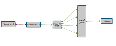

Hi @Federica Bossi I am using algo builder to generate the bin file.
‎2024-01-12 6:11 AM
Hello @DavidThomas,
Would you please share with me the AlgoBuilder project file and datalog with sensor data (accelerometer, gyroscope and magnetometer) so I can analyze the issue?

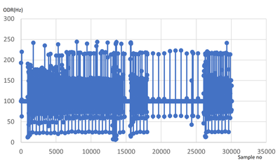

‎2024-01-12 8:00 AM - edited ‎2024-01-12 9:17 AM
Hi @Miroslav BATEK ,
I have added data log for your reference. That data stored into the SD card with 100 Hz rate. Sample data also not logged in 100Hz. Thank you

I'm aware about timing inconsistency when logging to SD card, we are working on that but it will take use some time to fix it.

You can modify the AlgoBuilder firmware template in your AlgoBuilder installation folder. Usually it is in c:\Program Files (x86)\STMicroelectronics\AlgoBuilder\ProjectTemplate\Project\Src\. There is MotionFX_6X_Init(void) function in ab_sensor_hub.c file. Here you ca modify the knobs i.e. add line ipKnobs->ATime = 100;. You can play with the settings.
After firmware modification you have click on Firmware->Re-Initialize Firmware to apply the changes in your project folder and then build the project.
