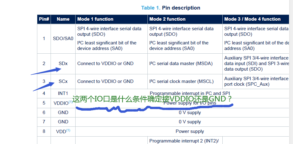

anne
Dear andrew
0693W00000QKibkQAD.pngPLS help us which conditon this item connect with VDDIO or GND?by the way,my e-mail adress is purchase@zeuselectronic.com,we need more help for this item,tks.
anne
Dear Andy Hurman
         pls check the following Pic ,this is pin description of part LSM6DSO,would you please help us
which conditon pin 2 and pin3 should be connected  with VDDOR ?which conditon pin 2 and pin3 should be connected with GND? or either of VDDOR and GND is ok?
