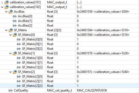

I am trying to perform a 6-point tumble calibration for my LSM9DS1 accelerometer. The returned output data from the MotionAC_Update is always as follows:
0693W00000APNhrQAH.jpgThe "is_calibrated" parameter is always 0, indicating the accelerometer is not calibrated.
The initialization is done the following way:

Petr S
Hi Pedro,
Your attached ACC data and time stamp seems reasonable so what I need from you now is the data recorded from one of your complete 6-position calibration trials to replicate/analyze your issue and find the root cause.
Best regards,
Petr
Petr S
During the calibration make sure you always hold your device on the table in each of the 6 positions for at least 2 seconds without any movement (almost stop breathing :smiling_face_with_smiling_eyes:). Never hold it in your hand in the air only because the movements are too high even if not visible.
Hi, Petr,
I guess that I misinterpreted the instructions on the MotionAC User Manual. It turns out that each calibration needs the six positions of the IMU.
What I was doing was calibrating each point separately. Now I can get the bias values.
Thank you for your answer.
