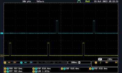

I have designed a circuit with the LSM6SDOX.
It is operating via the I2C BUS and the Gyroscope and Accelerometer are sending data. I have also managed to configure Single and Double Tap detection, however it is the tap detection where I have an issue.
When I single tap, it works and triggers INT1 on the Microcontroller, when I double tap, it also works and triggers INT2, however the double tap also triggers the single tap at the same time.
The registers are configured as follows in the function below.
Please see a screen capture from my Oscilloscope attached. Yellow is the Single Tap, while Blue is the Double Tap. Hopefully it will be self explanatory.
Can anyone point me in the right direction on how I stop INT1 from triggering when INT2 is detected?

Hi @Christopher1971 ,
Welcome to ST Community!
The single tap interrupt is triggered by the first tap of the double tap, so it has to be there.
What I can suggest is to check for both interrupts in the INT1 routine and continue doing what you have to do for the single tap only if just the INT1 is triggered.

Hi Federica,
Thanks for replying.
I'm very pleased as this means I understood the registers after all!
It is the best answer!

No problem, the code works, but as Federica has said, I need to write a function to separate a single click from a double click. I will do this via a timing "If" statement, that when INT1 is detected, it will wait for X milli-seconds to see if INT2 is also detected before changing the selected variable.
