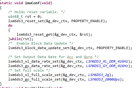

I'm trying to read step counts. I'm executing all pedometer related functions, but I get no any output.
Sincerely,
Talha0693W000008x0OXQAY.png0693W000008x0OhQAI.pngAnd While Loop

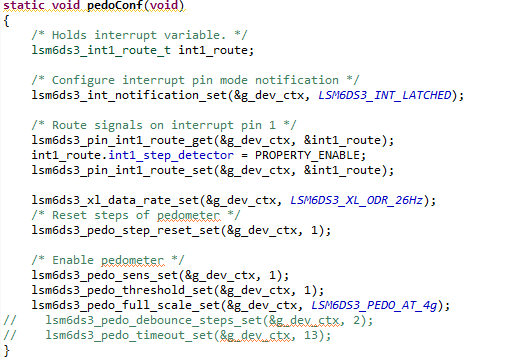

Hi @Eleon BORLINI​ ,
I applied the configurations in the application note as mentioned. But the result is the same, negative.
static void pedoConf(void)
    /* Holds reset variable. */
    uint8_t rst = 0;
    lsm6ds3_reset_set(&g_dev_ctx, PROPERTY_ENABLE);
    do
        lsm6ds3_reset_get(&g_dev_ctx, &rst);
    }while(rst);
    /*  Enable Block Data Update */
    lsm6ds3_block_data_update_set(&g_dev_ctx, PROPERTY_ENABLE);
    lsm6ds3_int1_route_t    int1_route_t;
    /* Set Output Data Rate for Acc and Gyro */
    lsm6ds3_xl_data_rate_set(&g_dev_ctx, LSM6DS3_XL_ODR_26Hz);
    lsm6ds3_gy_data_rate_set(&g_dev_ctx, LSM6DS3_GY_ODR_26Hz);
    lsm6ds3_xl_full_scale_set(&g_dev_ctx, LSM6DS3_2g);
    lsm6ds3_gy_full_scale_set(&g_dev_ctx, LSM6DS3_2000dps);
    /* Enable pedometer */
    lsm6ds3_****_sens_set(&g_dev_ctx, 1);
    lsm6ds3_pin_int1_route_get(&g_dev_ctx, &int1_route_t);
    int1_route_t.int1_step_detector = PROPERTY_ENABLE;
    lsm6ds3_pin_int1_route_set(&g_dev_ctx, &int1_route_t);
    lsm6ds3_int_notification_set(&g_dev_ctx,LSM6DS3_INT_LATCHED);
    /* Reset steps of pedometer */
    lsm6ds3_****_step_reset_set(&g_dev_ctx, PROPERTY_ENABLE);

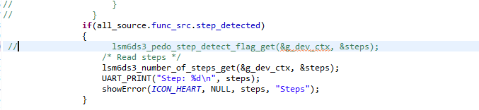

                if(all_source.func_src.step_detected)
                    /* Read steps */
                    lsm6ds3_number_of_steps_get(&g_dev_ctx, &steps);
                    UART_PRINT("Step: ");
                    UART_PRINT("%d\n", steps);
                    showError(ICON_HEART, NULL, steps, "Steps");
In while loop, the way that I check if there is a detection or not. What can it possible error and how can I solve it?

Eleon BORLINI
Hi @TKCK.1​ ,
I'm not sure if I well interpreted your code, but I suggest you to try to implement the in the way it is described in the LSM6DS3 application note AN4650, p.62:
1 Write 20h into CTRL1_XL // Turn on the accelerometer
// ODR_XL = 26 Hz, FS_XL = ±2 g
2 Write 3Ch into CTRL10_C // Enable embedded functions
3 Write 40h into TAP_CFG // Enable pedometer algorithm
4 Write 80h into INT1_CTRL // Step Detector interrupt driven to INT1 pin
This deploys the embedded pedometer feature, without the need of additional configuration of parameters such as debouncing and threshold.
-Eleon

Is this related to an issue with your sourcecode, or to this forum ?
Do you see ANY output from the accelerometer ?
Do a real-world evaluation, i.e. carry the board around while walking, and record the sensor output.
Let several different people do it.
Then you can evaluate possible "step thresholds".
Hi @Ozone​ ,
Yes, I can read acc&gyro values in all axis(x, y, z). Also I'm able to read Free Fall interrupts, tapping interrupts..
I have already real-world sensor ouputs, I recorded them. But in our project, firstly we need to read the steps simply. So I need to execute via registers.
Ozone
Principal III
So, as I understand it, the threshold setting via sensor config does not work, or not work properly.
Instead, consider evaluating the raw data directly.
