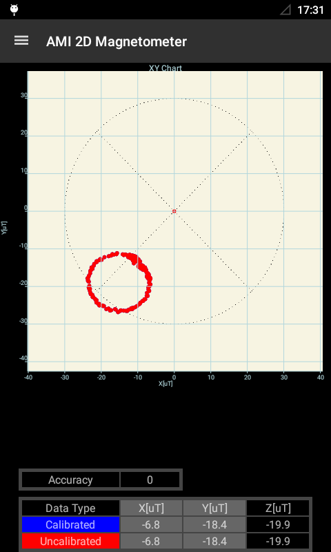

I use a LSM303C magnetometer sensor on an Android platform.
Sensor works fine, however automatic calibration (hard and soft iron) does not work. I checked it using an Android app displaying magnetic field vector in 2D, for both calibrated and uncalibrated data.
With my platform (Android 5.0 and ST MEMS driver + Android framework), calibrated and uncalibrated data are the same (red and blue text boxes), so it seems that there is no calibration algorithm running :

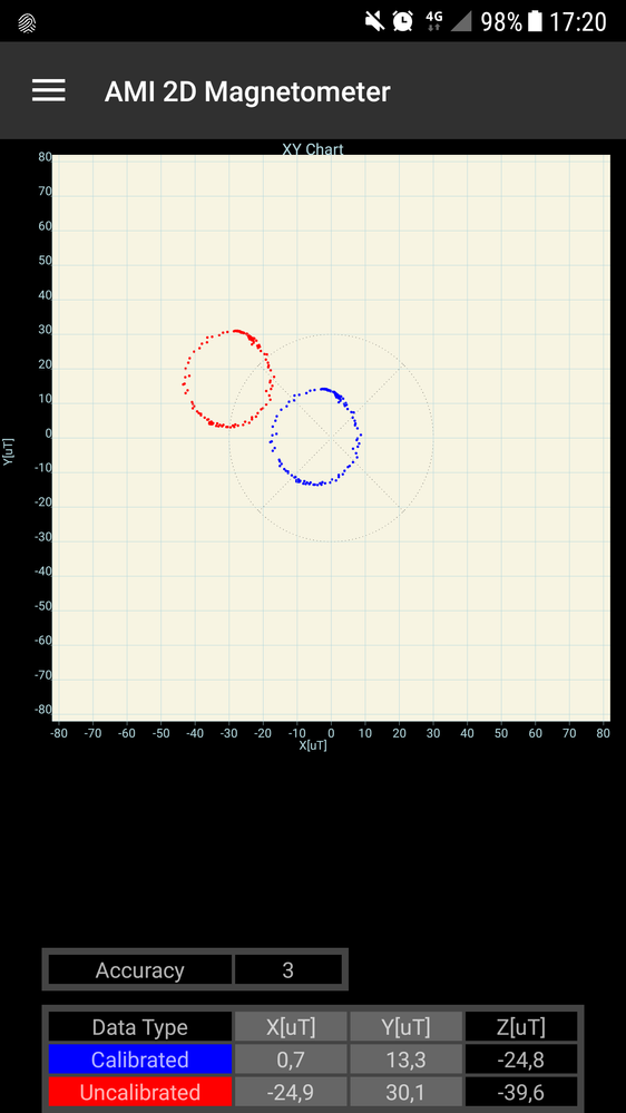

The same app tested on a Samsung S7 show calibrated and uncalibrated data after a full 360° rotation on Z axis, uncalibrated circle (red) is correctly shifted to calibrated circle (blue) :
How do I activate calibration on Android for LSM303C device ? ST framework code source mention an obscure STMagCalibration_API (which should do the job I guess), however i'm unable to find any source code for this library ...
Any Advice ?

    hi, which kind of auto-calibration algorithm are you using? Pls consider that the suggested movement for the magnetometer calibration is not a full rotation around z-axis, but an 8-movement of the wrist carrying the magnetometer (in a smartphone) like the one shown in the picture below. Regards

    Hi Eleon,
    In fact, that's the point : I don't know how to enable magnetic auto-calibration on Android for LSM303C sensor. We uses the ST provided Android HAL (https://github.com/STMicroelectronics/STMems_Android_Sensor_HAL_Input) and it'seems that HAL can be configured for enabling auto-calibration. However when doing so, compilation miserably fails because of missing libraries. From the link above, I guess that some STM proprietary libraries are also needed :
