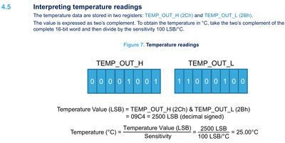

may i know lps22df temperature offset register?
want to read the correct value at 25 degrees in the temperature chamber,
but it seems to be read as an incorrect value.
Please me, know if there are any other ways to compensate for the temperature
1 reply
December 18, 2024
The data sheet will have information on how to read out the temperature, including the register addresses.
What value does it read? What value are you expecting?
