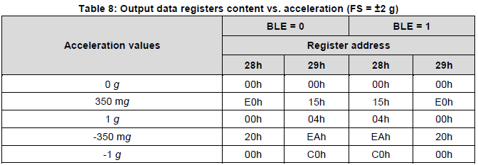

In an attempt to better understand the process I have been working with AN3308 Table  8 Example of Acceleration Data. I worked on the +350mg and -350mg examples and they worked as expected:
-350mg = 0xEA2h -> invert -> 0x15Dh -> +1 -> 0x15Eh = {256 + 64 + 16 + 8 + 4 + 2} x -1 = -350 x 1mg = -350mg
350mg = 350 x 1mg = 350mg
However this approach falls apart when working with the +1g and -1g examples. Given the data is held left aligned in two's complement I would have thought the values should have been:
-1g = (-1) / 1mg = -1000 =  0xC18h     BUT it is given as 0xC00h which is -1024.
+1g =   1  / 1mg =  1000 = 0x4E8h      BUT it is given as 0x040h  which is 64.

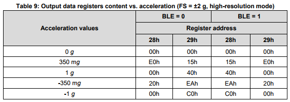

October 26, 2017
Posted on October 26, 2017 at 15:51
Oh, I see, it seems you have old version of the application note with the error.
Please download the latest version of
http://www.st.com/content/ccc/resource/technical/document/application_note/77/ed/e7/e1/28/5a/45/d6/CD00290365.pdf/files/CD00290365.pdf/jcr:content/translations/en.CD00290365.pdf
