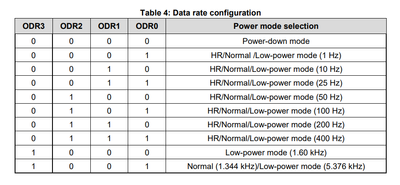

LIS2DH12 accelerometer. Datasheet AN5005 shows Table 4.
Is this the speed of data transfer via the SPI or I2C interface? Or the speed of converting data into accelerations and writing this accelerations to the OUTX_H and OUTX_L registers?

It is the output data rate, the rate at which a sensor obtains new samples.

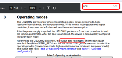

The Datasheet never once gives the meaning of the "ODR" abbreviation.
The Application Note uses it four times before finally mentioning the meaning on page 9 - and that's just in passing:
Even that's not very clear: it could be bits per second, bytes per second, etc, ...

Hi @Andrew Neil ,
As in the screenshot posted by @MykolaLevun the unit of the ODR is Hz.

Hi @Andrew Neil ,
As written before, ODR is output data rate and thus the unit is samples/s where samples means the output value of the sensor stored in the output register.

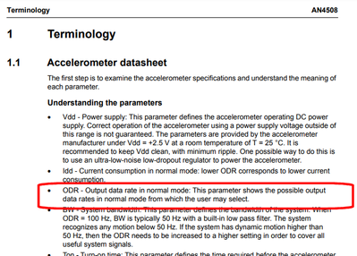

There's also Application Note AN4508, "Parameters and calibration of a low-g 3-axis accelerometer"
It has a 'Terminology' section, but still doesn't make it clear:
