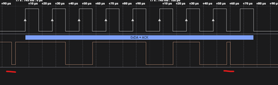

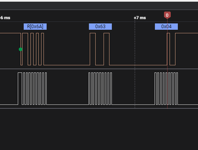

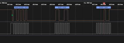

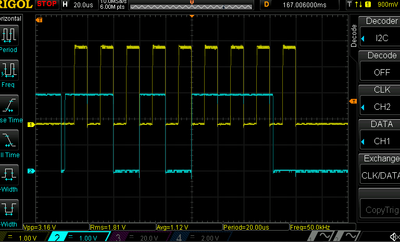

I then further put a scope and logic analyzer to the signal at a very I2C clock low frequency (50kHz) to try and see if this data comes directly from the chip or not.
This is an example transaction where the data is read out:

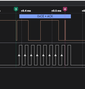

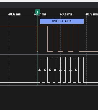

Zoomed in point 1:
Reproduction of zoom point 1, but with scope and analyzer attached

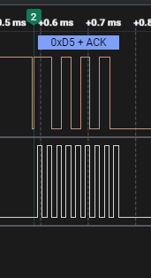

Zoomed in point 2:

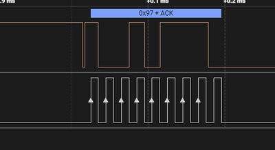

Reproduction of point 2:

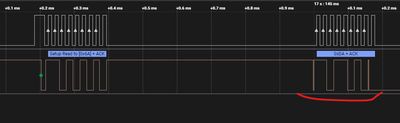

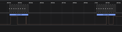

Most of the time, we get something that looks like zoom 1. And sometimes, we get zoom 2 - in which case we see different data (especially in the most significant (last) byte.)
What's weird aside from the pattern changing, is that even in zoom 1 SDA is toggled for a very brief time (2us, while the clock period is 20us) before the clock starts. (Sometimes it also does this near the last cycle as well - but this seems to be more random)  The first glitch seems to happen every time when reading the data registers (0x28), but not for instance when reading register 0x10 .. when we also read out scenario (zoom) 1. In scenario 2 - the initial glitch is -not- there.
So, basically I am seeing the I2C signals clearly varying form time to time (scenario 1 to scenario 2), showing this sporadic higher value.
But in addition to that,  the data glitches bother me - and they do seem to be correlated with this behavior.

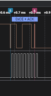

I took a longer trace, that corresponds to the salae output in attachment.
Using the markers, you can clearly spot the different scenario's

SCEN1:
ArnoutDekimo_8-1721835956626.pngArnoutDekimo_9-1721835969872.pngArnoutDekimo_10-1721835981383.pngArnoutDekimo_11-1721835991829.png
Scenario 2:
=> Does this ring any bell? Has anybody seen similar behavior when the chip responds to I2C readout?

Your rising edges look too crisp. Almost like your SDA/SCL pins are in push pull mode rather than open-drain.
Looks like an issue on the host side rather than the device side.
July 25, 2024
The reason they look "crisp" imo is because I lowered the frequency from the theoretical 1Mhz to 50khz. Slow anything down sufficiently, and it will look like a perfect square, no matter what the pullups/driving.
