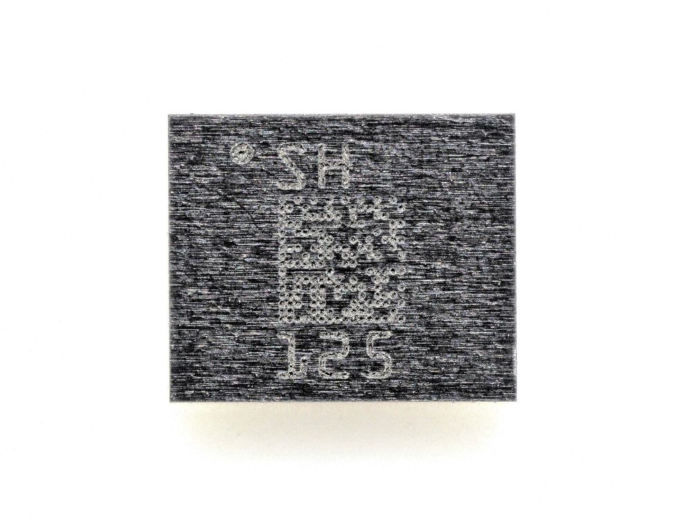

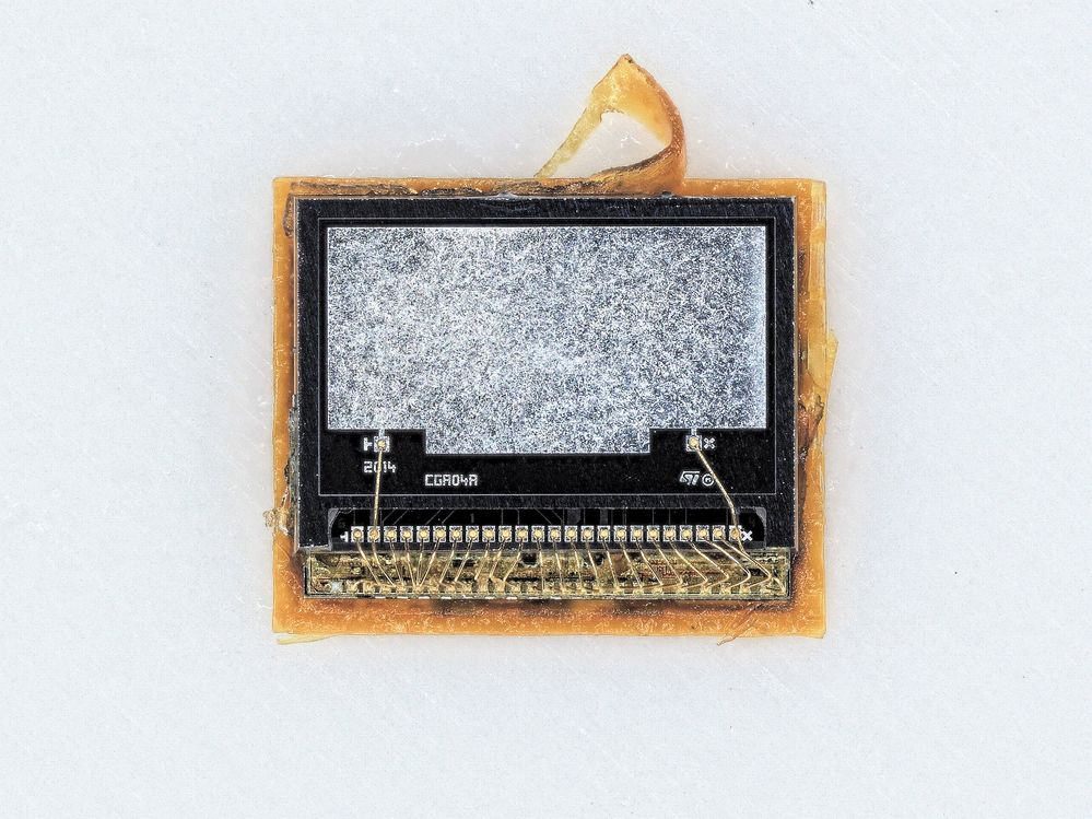

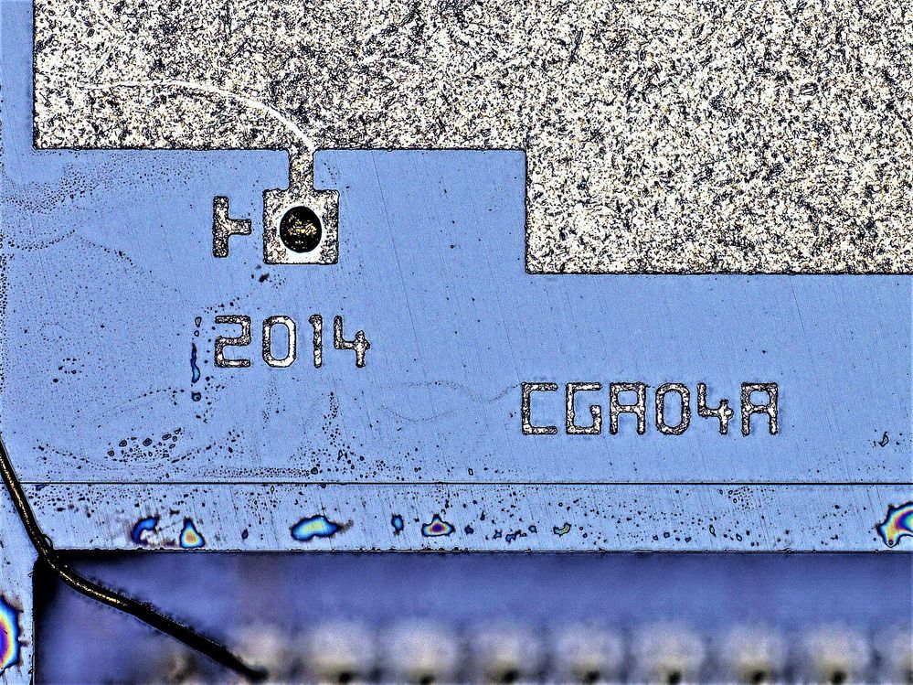

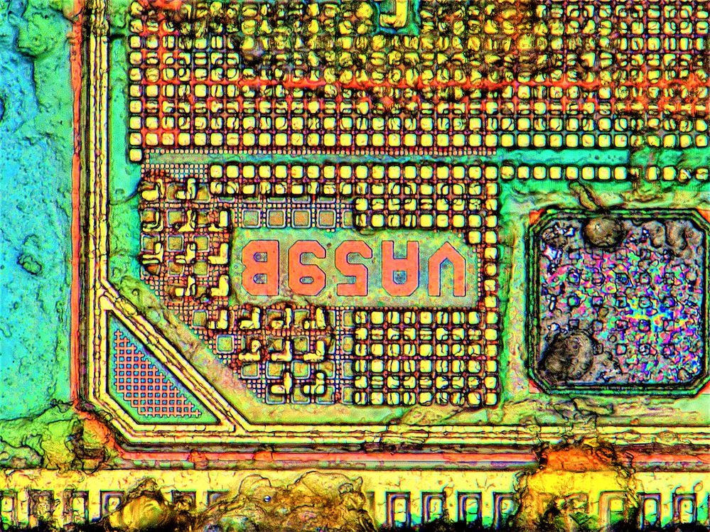

I have an ST component that I have a question about; specifically the die markings. I was wondering if the markings are authentic to this component given the following information:
DCole.1
1) Part Number: LSM6DS3HTR
           2) Date Code: 2125
The markings on the die read:
 1)   ST, 2014, CGA04A, VA59B
I apologize in advance if this question was posted to the wrong section.

Peter BENSCH
Welcome, @DCole.1​, to the community!
Which marking can be found on the packaging bag?
Is it possible for you to attach a photo of the device that is as recognisable as possible?
Regards
/Peter

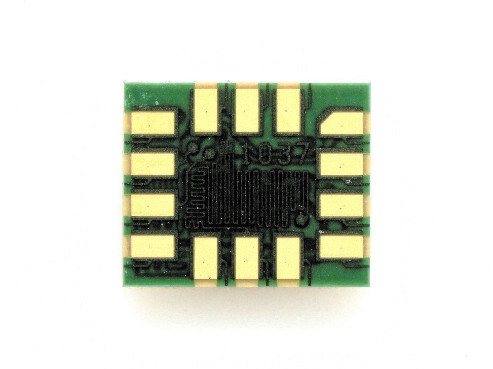

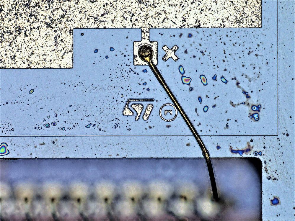

DCole.1
0693W00000Nr0cnQAB.jpg0693W00000Nr0f7QAB.jpg0693W00000Nr0f2QAB.jpg0693W00000Nr0exQAB.jpg0693W00000Nr0edQAB.jpg0693W00000Nr0eYQAR.jpgOf course. Here are the photos of my component, including the die and the die markings if that helps.
Peter BENSCH
Oh, I see, you took the markings VA59B and CGA04A straight from the die itself.
However, there is no official information for this, but the package marking SH stands for LSM6DS3xx, e.g. for the LSM6DS3, LSMDS3H. Please note that the LSM6DS3H is discontinued. For more information, I recommend making a personal request at Online Support.
