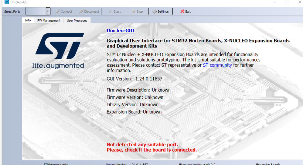

I am trying to connect my sensortile.box with Unicleo-GUI, but it shows an error saying that the port is not detected. I am using windows 10 kindly help me in this Regards
Usman

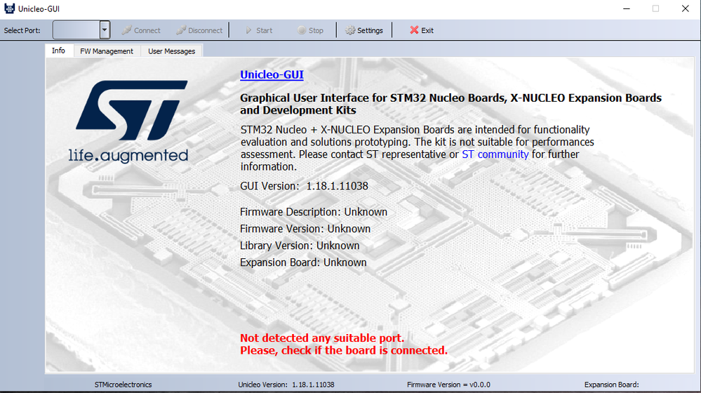

Hi @Eleon BORLINI​ ,
My unicleo gui said also the same. I have browse that binary file through STM32CubeProgrammer(firmware) and also had download this already FP-SNS-STBOX1, . Can You tell what is the issue, then?
