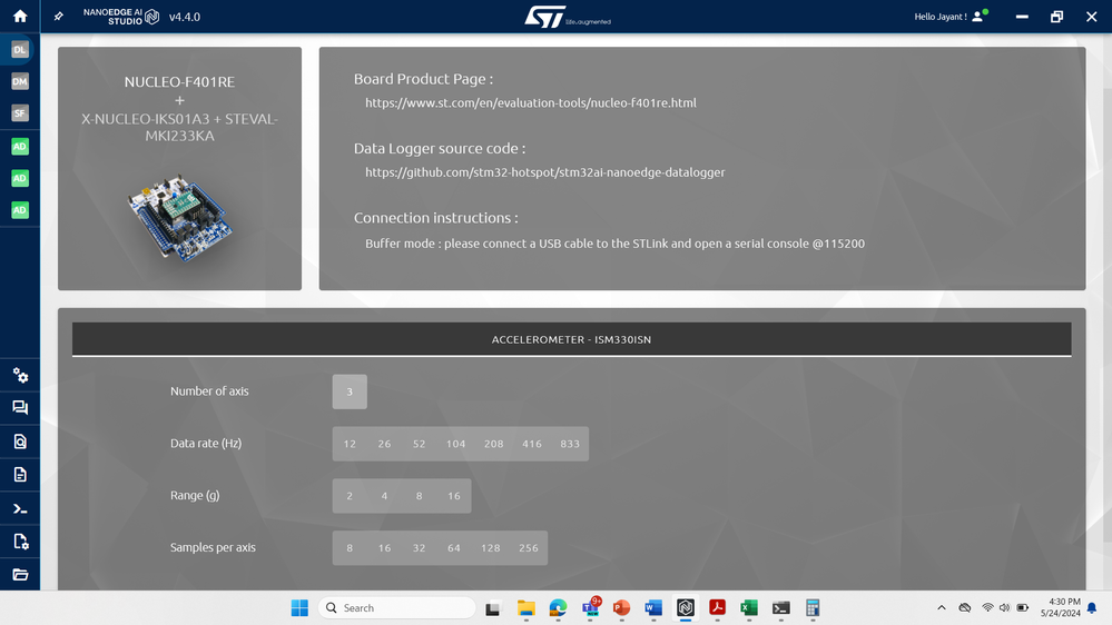

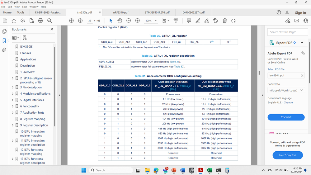

As mentioned in the datasheet of ISM330IS, we can go to accelerometer ODR of 6667 Hz but in the NanoEdge AI Studio, it is showing only upto 833 Hz. Can you tell how can we go above ODR of 833 and the. Also how can we go above Sample per axis i.e. buffer size of 256 ? @Denise SANFILIPPO @Eleon BORLINI
