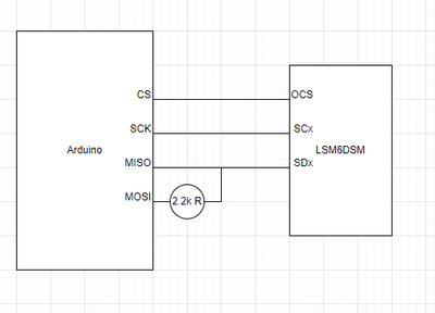

Today I came with some interesting observation, I Was working with LSM6DSM sensor interface with Arduino and writing the driver code for same. I was able to achieve 4 - wire communication between Arduino and Gyro using a logic level shifter. But, I am not able to achieve same, for 3 wire. My connections for 3-wire or like this,
Also I have Updated the 3-wire config register in the 70h register, I am Enabling SIM_OIS, 500dps [ FS1-0], and OIS, so I am writing 0x25 in 70h. What I am receiving is 0xFFs as the device ID, and -1 , -1 , -1 as x, y and Z value.
Also when I short MOSI and MISO with 2.2k resistor, my device ID is detected as 0x80h and getting a -32640, -32640, -32640 as x, y and Z value.
, So , i am not sure what else i am missing here, so basically my question is , how to connect LSM6DSM in 3-wire mode. If any help provided by any will be helpful. @Federica Bossi

  1. If the microcontroller support it, it's advisable to configure the SPI in half-duplex and avoid the resistor entirely between miso and mosi.
  2. You should check with the oscilloscope before and after the resistor to check how much the signal is dropping but with the information given I think you can increase the value

This is not the best way to connect SPI3w to Arduino, by the way if you want to use these configuration, I suggest you to increase the value of the pull up resistances.

1. Then what is the best way to connect SPI3w to Arduino. Leaving the MOSI floating , just did not detect the presence of the Gyro LSM6DSM.
2. Increasing the resistance , will that lose the data ?.

Thanks for the response and your help. I will check on the same, as you have suggested.
