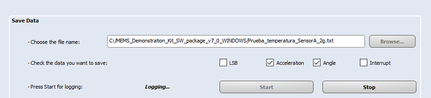

I have a LIS3DH sensor and Unico 7 in my computer and I am using the evaluation board MKI109V3. The thing is that I want to save the temperature data (measured by the Embedded Temperature sensor inside the LIS3DH) in a log file and with Unico this is only possible for Accelerations, LSB, interruptions and angles. It is not possible to save also Temperature? How can I do it? If not, how do you recommend me measure and save this data?

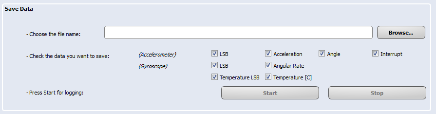

hi vicente, which .dfu version are you using? Please check if it is ProfiMEMSToolV2.30.3. In Load/save section, you should have something like this:

Hi Eleon, I see that there are options for gyroscope too. Is that the same sensor? I am using a LIS3DH with MKI-105V1 adapter.

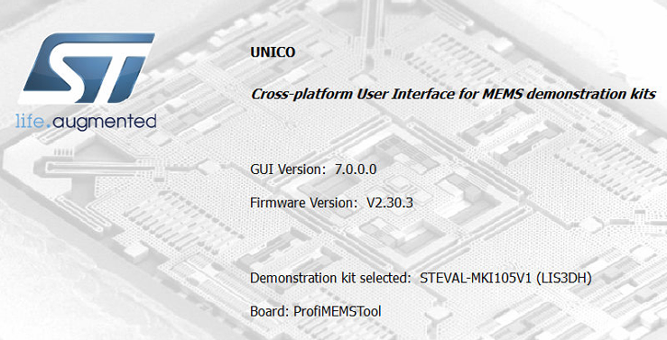

Hi Eleon,
Yes I uploaded the ProfiMEMSToolV2.30.3 that is in the DFU folder of the MEMS Demonstration Kit SW package for the MKI109V3. In the Load/save section I only have these options. Perhaps the Unico version is not recent? It is the 7.0.0.0.

hi vicente, I posted the most generic interface. Unfortunately, for some sensors there is only a subset of automatically-saved data.
There is however a way to log the data that don't appear in the "load/save" tab, but it is not so straightforward. You can connect to your STEVAL-MKI109V3 via an hyperterminal (e.g. Termite), and communicate via VCOM. Then you can send via Termite the commands to configure the board and get the content of the registers you need (in case of temperature, REGs 0x0C and 0x0D).
*setdb105v1 // set the correct embedded FW
*Zoff // enambel MCU communication with the sensor
*w2047 // set the device in normal mode
*w2380 // set the BDU (block data update) bit
*w1FC0 // enable temperature ADC
*rm0C0D // read temperature data from REGs0x 0D and 0x0D
To automatize the reading, you should write a script in some language (e.g. python) sending the above command via VCOM.
