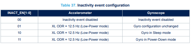

The datasheet mentions that the current consumption for the Accelerometer in Low power mode is 9.5 uA. I believe this should the be the average current consumption when INACT_EN is 3 and the LSM6DSM is checking for activity.
I took a look at the implementation in the STMems Standard C Library and the lsm6dsm_act_mode_set function should set the INACT_EN bits
Also, I commented out the code to set the interrupt to latched and I'm still seeing the same current consumption values.

Also, does the gyroscope need to be switched on for inactivity interrupt? Does the gyro ODR affect the duration of the inactivity interrupt is set?
I also noticed that I did not receive an inactivity interrupt when I turned off the gyro. I did notice a drastic change in the average current consumption(0.06 mA).
Unfortunately yes, the gyro ON is needed for the Activity/Inactivity pattern recognition.

I'm a bit confused with your reply. You mentioned that "Unfortunately yes, the gyro ON is needed for the Activity/Inactivity pattern recognition.". If the gyro is required for Activity/Inactivity, then why does the INACT_EN[1:0] bits provide an option to power down the Gyro? Is the gyro required for detecting the Activity portion of the interrupt, Inactivity portion or does it need to be turned on for the duration that the Activity/Inactivity interrupt is used?

‎2020-09-25 6:53 AM
Hi @GTS.1​ ,
regarding your first question, the gyro part of the sensor is involved in the Activity to Inactivity pattern detection, and then can be put into sleep mode.
Regarding your second question, the Wake up interrupt is basically the "dual" action of the Activity/Inactivity interrupt: the device is inactive (except from the accelerometer) and configuring the wake up settings (enabling, threshold, duration, etc...) it can be recovered into normal mode.
