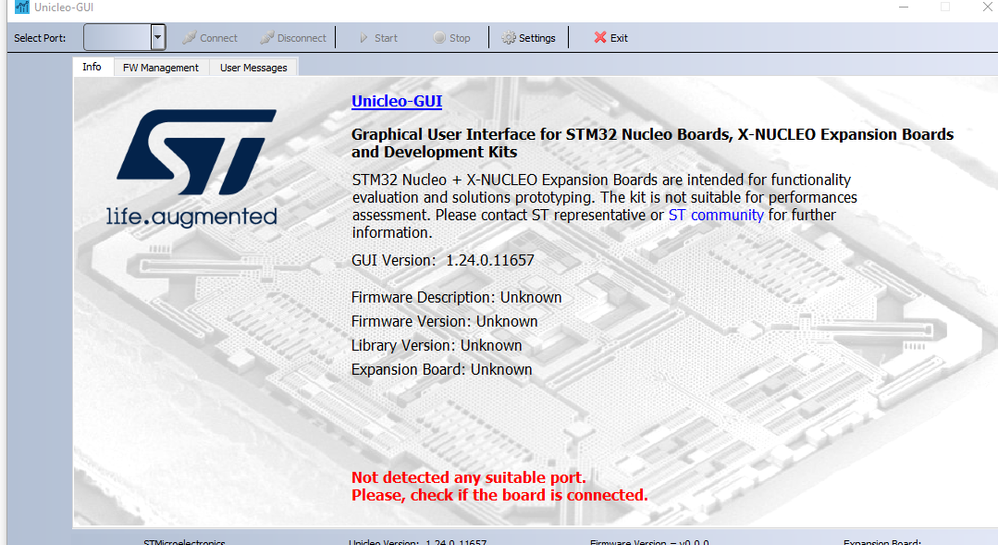

Hi , My unicleo gui said 'not detected any suitable port'. I have browse the binary file(/DataLiogExtend) through STM32CubeProgrammer(firmware) and also had to download already FP-SNS-STBOX1, Can You tell what is the issue, then?

    Hi @ZFerd.1 (Community Member)​ ,
    Try to:
    • Remove the automatic port recognition
    • Check whether indeed the box is visible from the control panel in the COM PORT
    Let me know.
