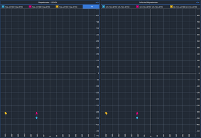

Hello @Petr S
Yah!!  by mistake while printing  the data i have printed the accelerometer both y and z axis as same sorry for inconvenience!!! here is the exact data that i am being received from sensor.
I have considered UM2192 for my reference.
Please find the attached.

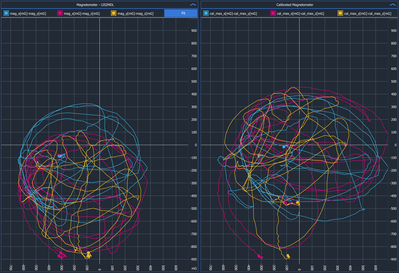

Petr S
May 30, 2024
You're right, only magnetometer data are needed. But the data in your last datalog shows you're not rotating the board at all.
You need to rotate the board around all 3 axes (ideally more than 360° around each axis). Then the elliptic magnetometer data are transformed into sphere and shifted to 0,0,0. The transformation parameters are actually soft iron and hard iron calibration parameters. See the example of my datalog I sent you before:
