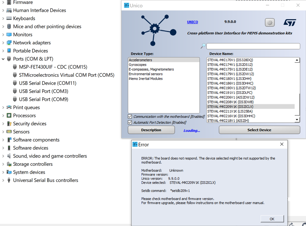

I was able to install all executables, Eleon, the ensemble just doesn't work.
First, the adapter board in STEVAL-MKI209V1K was too wide for the headers on mother board STEVAL-MKI109V3. The pins were not soldered perpendicularly. Fitting it was hard; refitting it as part of troubleshooting was maddening. Thus, the bleeding thumb, a few bent pins, and the frustration evident in yesterday's post.
Fundamentally, I couldn't establish a connection, illustrated in the enclosed screen shot.
Each set of instructions referred me to another. I finally gave up after unsuccessful attempts to update the firmware. Fundamentally, STMicro's efforts to make one kit serve every MEMS has produced a user experience that serves none.

Update:
I figured out how to reflash the motherboard with file ProfiMEMSToolV3.14.5.bin. The Unico GUI continues to malfunction. It usually crashes, almost immediately. I was able to produce the error window every other try yesterday, but this morning it just fails abruptly after each try.
Is there a log file?
-- R.

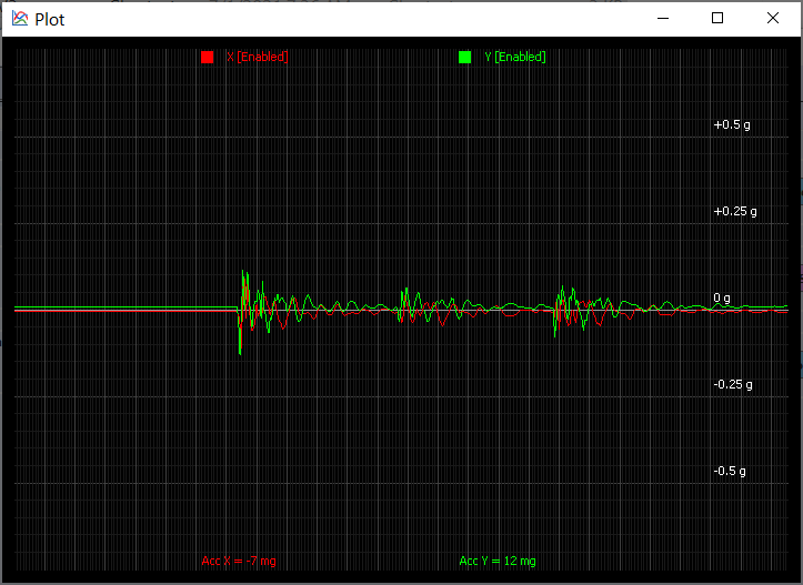

Roger Lambert
0693W00000BcYz3QAF.pngFinal update:
I unchecked the automatic port detection and somehow made the Unico connect. Here's me pounding my desk.

That's good @Roger Lambert​ ,
The fact is that -in order to keep this general purpose evaluation board updated-, we periodically release new version of both Unico GUI and the profiMEMS firmware, in order to support the newest products. A periodical FW update is for this reason suggested.
I'm not sure why the automatic port detection prevents the board to be detected form the operating system, but glad to hear you have been finally able to connect it and make it working.
